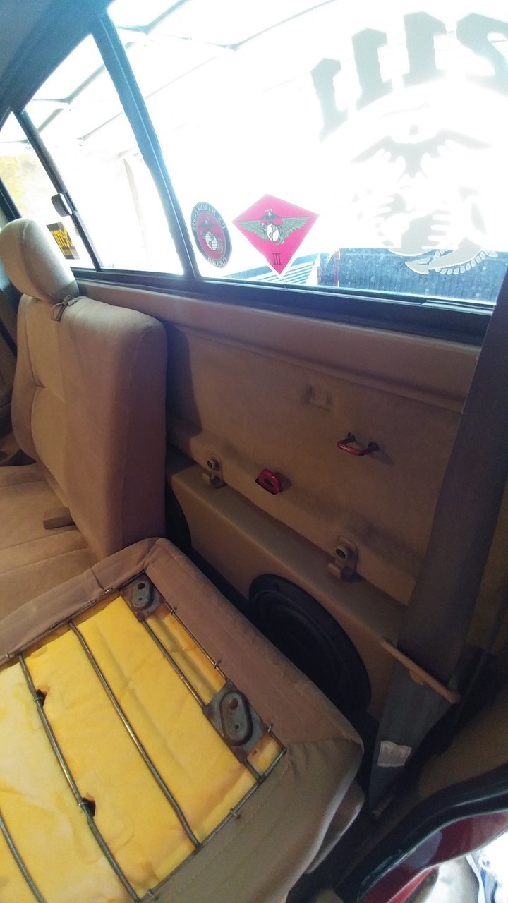

    I'm running a custom built sub box with (2) shallow mount 8" Pioneer subwoofers in my 02 DC Pre Runner and it thumps hard !!

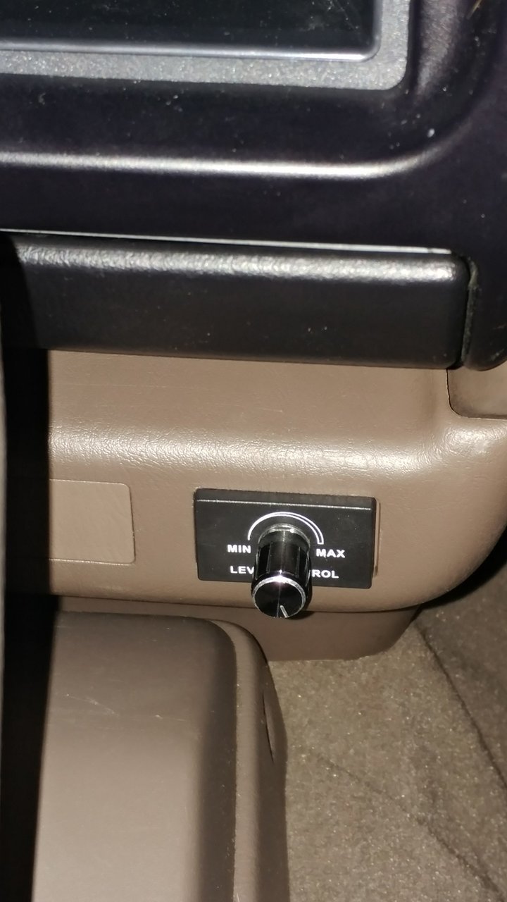

    I'm also running a subwoofer volume control knob so I can adjust the subwoofer easily depending on music
    Sub volume control
    Custom sub box

    Don't suppose you have a link or brand/model for your bass knob eh?
    Is that the kind that plugs into your sub/amp via an old school "phone jack" plug? Sometimes the bass is a tad much sometimes its not there and trying to adjust the level via the HU is a pain for one song.

    This is my bass knob that connects to the Arc amps.
