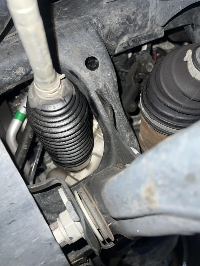

    Call the toyota brand engagement center. 1800 331 4331. Explain to them. They will reach out to the dealer. Should replace under warranty.
    WESTERN308[OP] likes this.

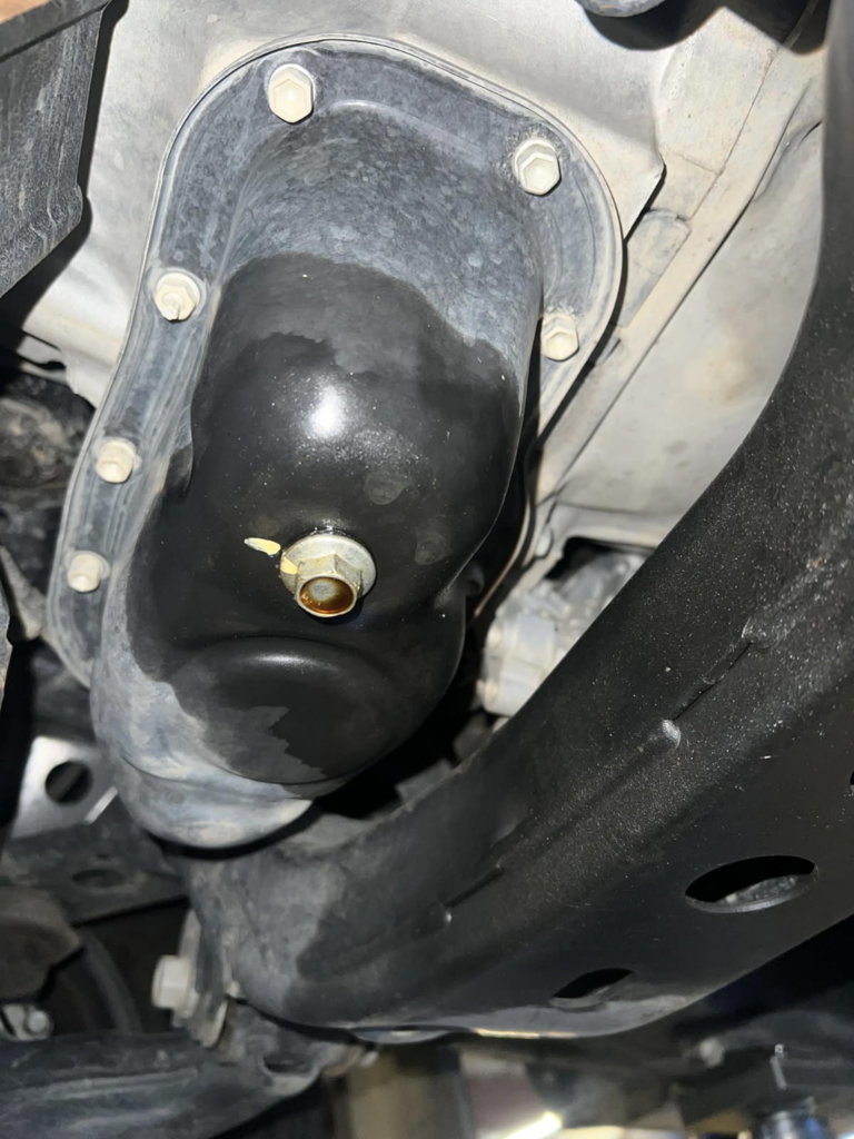

    You’re leaking engine oil. I bet the drain plug was put back in without the washer.
    Fix that first. Then evaluate how “bad” the rack is actually leaking.

    OP states he is topping off the PS monthly. Presumably, he already knows almost precisely how bad the leak is.

    Great news. Just received a call from Toyota Brand Management. They will replace the gearbox under warranty next week! Thanks to all for sound information and direction, especially Jsevert2023!:):)

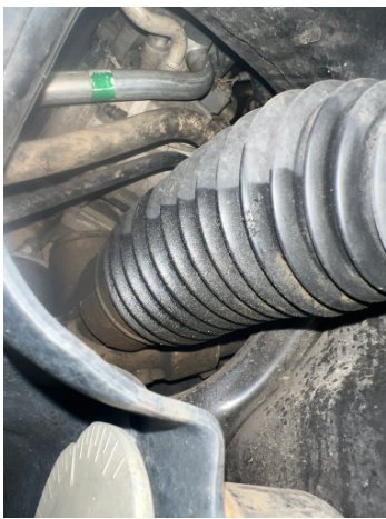

    Purchased Toyota Certified, with Vijay bumpers, additional lights, and Falken Wildpeaks on Fuel rims. Prev owner apparently painted the grill.
    I have my '22 in for the 60k service (62,500 on the ODO) I'm a second owner and I'm being told it needs a new rack. My CPO extended warranty covered one year and 14k from purchase (March 1 2024, at 43k). Is it worth me calling corporate or am I in the 'monitor fluid and fill' for a while?
    Picture from the dealer inspection:

    I would say you're well into the latter.

    My 15 has some dampness at each boot, the level in reservoir never really goes down. I'm not worrying about it until I see the level start to actually drop
