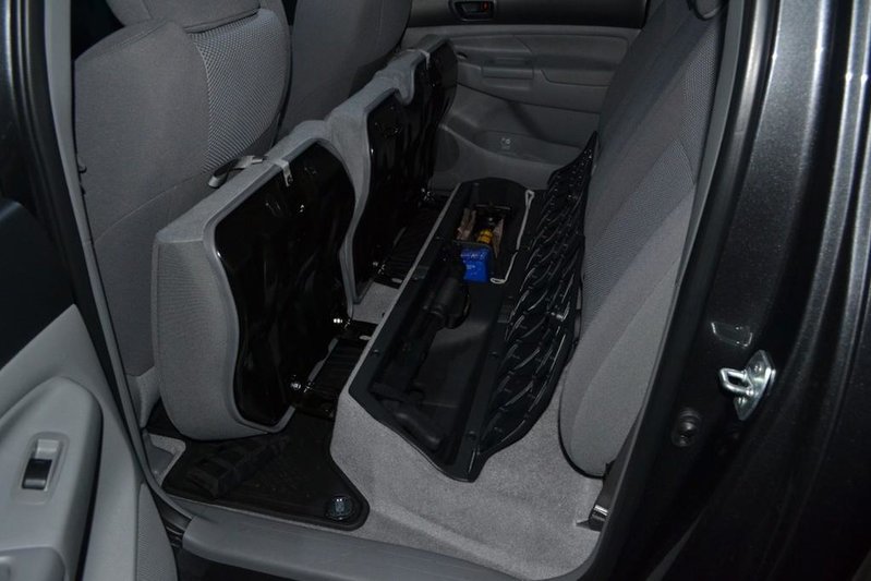

    I am trying to figure out how i can fit 2 12 inch subs under my back seat. Has anyone attempted this ? I have a box behind the seat already with 2 12s but its just not egnough.

    You are not going to be able to get 12s under your seat. That would require some serious fabrication and some cutting of the truck. People have put 8s and 6.5s under the seats but anything larger than an 8 wouldnt fit. You are going to have to put 12s behind the seat, in a box that sits on the seat, or do a bed cut.

    Well if you are willing to cut up your truck... You may be able to get some very shallow mount 10s under there. I would definatly require a sealed fiberglass box, however i would be concerned with airspace. Without the proper airspace the subs are not going to perform to potential.
    I think that with 4 12s you should do a bed cut and put them in the bed of your truck. That way you can build a nice that will house all 4 subs together and have the required airspace, and you wouldnt be limited to shallow mount subs also.
