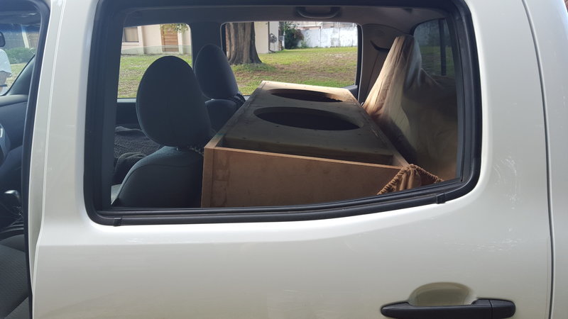

    Sits ontop of storage bins.

    Heh, go big or go home. Looks like it needs a LOT more port volume though.

    Now yer talkin'. That'd give you 3 times the space you'd have with stock seats.

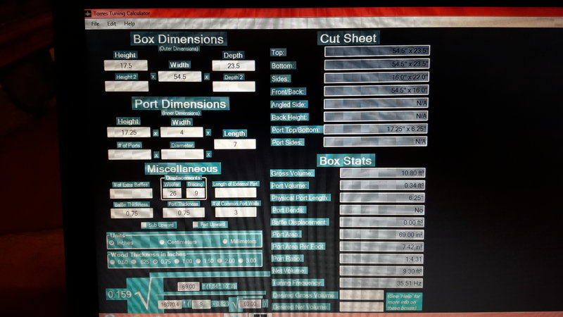

    I thought so too but all the calculators i was using said this would work, so if it doesnt then ill make a new box i suppose

    Oh, it'll work, but your tuning frequency might not be where you'd like it. 2 subs in the same airspace is less than ideal as well. What software did you use?

    Torres calc, and tried the 12volt.com

    Huh. And it's tuned almost right at Fs. Here I sit eating my words according to Torres, but would probably try something like WinISD for a 2nd opinion. Those subs are really high Qts, so that just might work nicely. It's already built though, so one way to find out. Can't wait to hear what you think. I wish I had 11 cubes to work with.

    Thanks ive been worried about the 7 inch port lol. But i figured it was worth a shot. Re calc wasnt working for me at all
