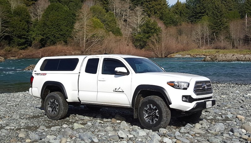

    Have to admit, a level truck looks trim and tight. But of more importance to me, is when I drop 300lbs of trailer tongue weight on the hitch, that is when I need the truck level. I keep trying to convince myself to raise the front and back the same amount with 5100s and perhaps an AAL, but the truck is set up with 4600s and has the rake I need, and this is WITH a Snugtop shell on it. There is no good reason to raise a truck which is setup correctly from the get go. Oh, wait. I did put a set of Sumo Springs on the truck to help hold up the rear end a little more, and they work very excellently.
