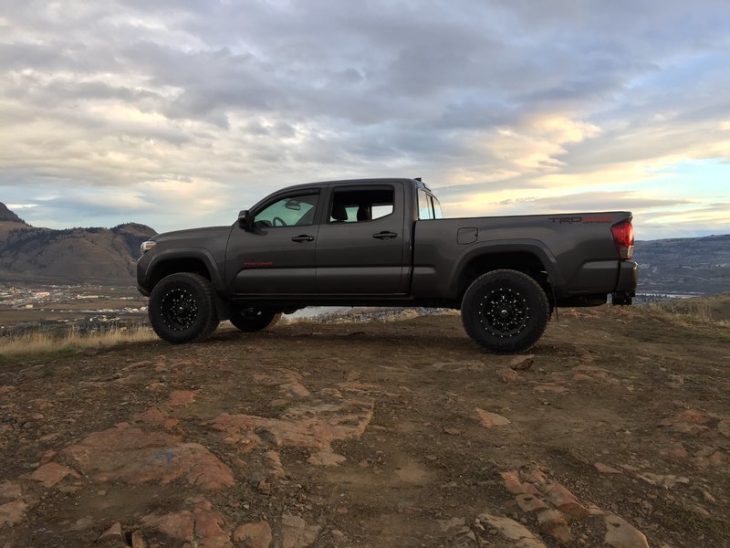

    IMG_1952.jpg This is with a 1.5" block and 2.25 up front on the sport but swapped to off-road suspension and skid plate off the pro

    You are right on 16 plus though a 3" lift spacer would be pushing almost 4" as the coil is longer on 3rd gens so with a 2.25" lift spacer it's right around a 3" lift from a 2nd gen and add a 1" block in the rear is level I added a 1.5" rear block so I don't sag when I carry camping gear

    Thank you... were you happy with that lift? And what size rubber is that?
