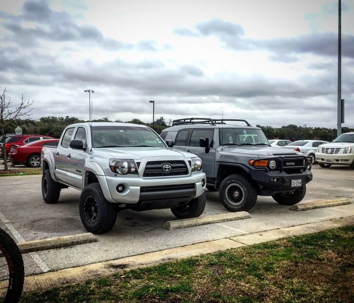

    image.jpg 265/75 with billies with eibach/toytec coils on the 2nd clip and an aal in the back

    That's a sweet truck man, just what I'm looking for. Plan on adding a topper too. Thanks for the pic. Did you upgrade the shocks?

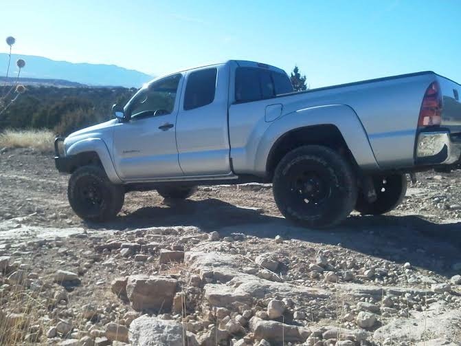

    OME with 265 75 16's

    Are you talking billies & toytec coilovers?

    5100s with the toytec 620lbs coils. Not coilovers

    Yeah i had to do the same when i was looking at lifts. Coilovers have the threaded adjustment to fine tune the preload/lift. While my setup (bilstein 5100s with toytec coils) has 2 clips available for the ammount of lift i want. Lowest clip is around 1.6 inchs and the 2nd clip is around 2.5. With the billies and ome you use the spring length/ weight or adjustment clips of the shock to determine the ride height of the truck

    '07taco
    '07taco Active Member
    Jan 21, 2016
    #175676
    29
    Aaron
    Colorado
    I wish I knew. It was on there when I got it. I would assume 886's.

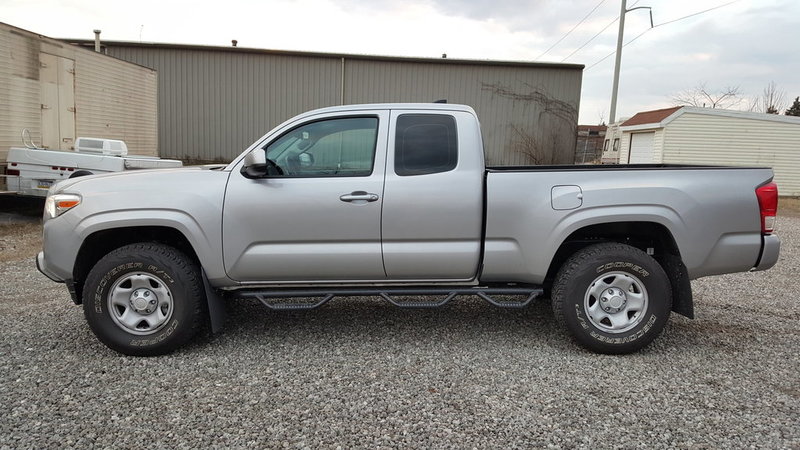

    AugustaTaco
    AugustaTaco Well-Known Member
    May 22, 2015
    #155836
    3,941
    Josh
    Augusta, GA
    2015 DCSBXSPX4X4 2017 GX460
    "Getting out of hand" - Wife

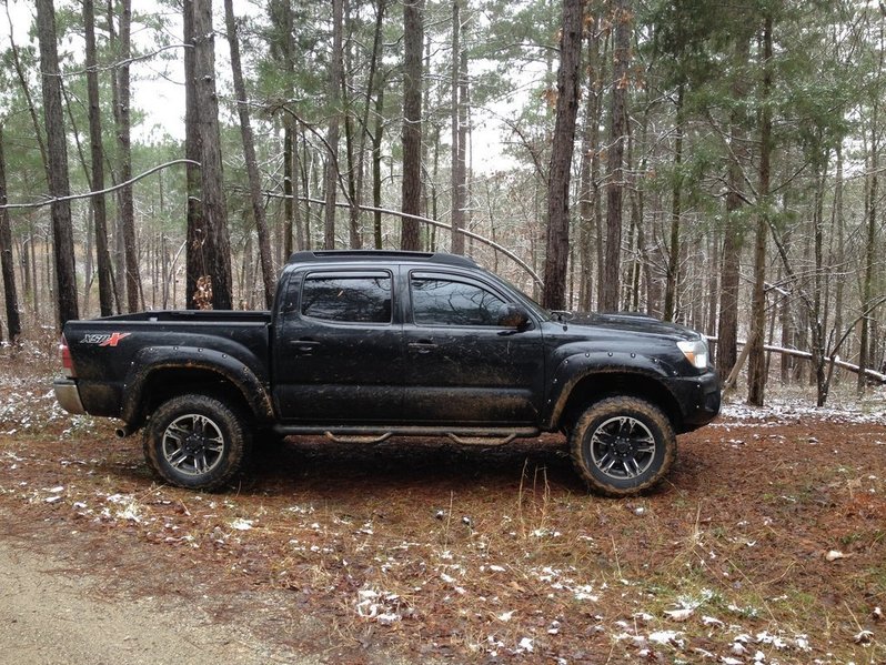

    moe2o4
    moe2o4 Well-Known Member
    Feb 9, 2015
    #148236
    7,849
    Corey
    Pittsburgh PA
    2016 SR Silver 2.7L 5 Speed
    OME 3" Lift, 32" Tires, Lots of Mods!
