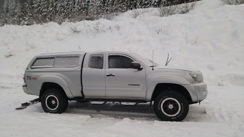

  6. Jan 25, 2016 at 7:06 PM
    #66
    Big Sky Country
    Big Sky Country [OP] Well-Known Member
    Oct 11, 2015
    #166432
    314
    Montana
    2013 DCSB TX Pro
    Century topper, OME 885x, Nitrochargers, full Dakars
    That's why I'm asking, I think 2-2.5 is perfect for my needs. Selling my old truck so planning on using that money to upgrade the tacoma. Thinking Dakars or AALs (until they sag) because I'm also adding a topper.
    Spend all my free time in the Trout Creek, Bull River, Noxon area looking for groceries in the fall

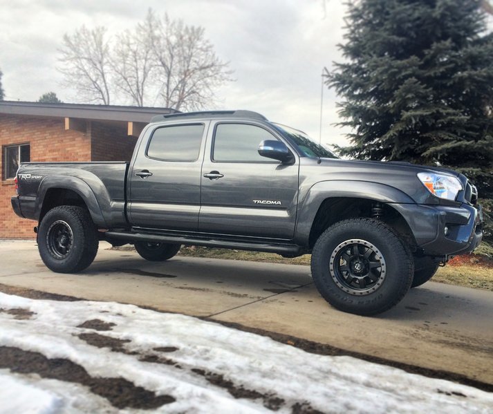

    yeos
    yeos OCD Member
    Feb 24, 2013
    #98297
    1,221
    Moses Lake, WA
    2007 Lexus GX
    Front: bilstein 5100s set at 0 with eibach 2.5" springs
    Rears: wheelers 3-leaf 1.5" add a leaf, kept overload on factory 3 leaf pack.
    lorsteez, GeoScout and ChadsPride like this.

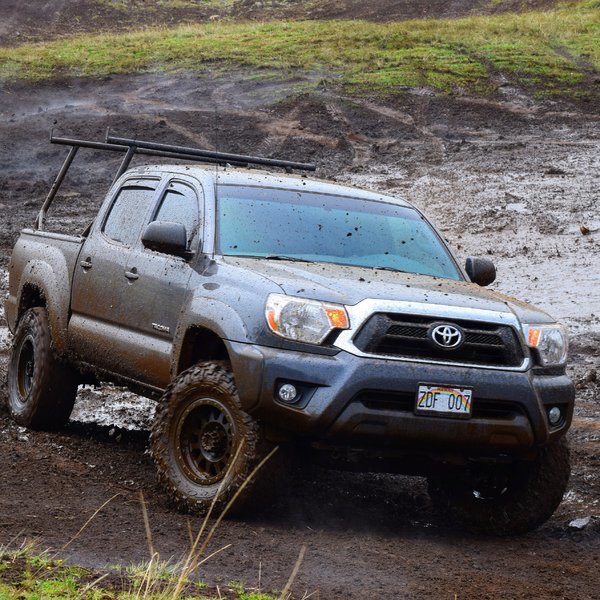

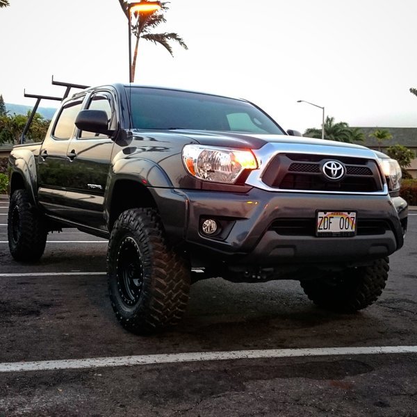

    Big Island, hawaii
    MGM 2015 dcsb trdoffroad
    Icon stage 3 with tubular uca's and rear reservoir shocks.
    285/70/16 Nitto trail grapplers, it's an odd size I think only Nitto has it, they're about 31 1/4 tall on the truck with the 285 width.
    16x8 method double standards 0 offset.
    I've wheeled the shit outta my truck with no major rubbing at all.
    I have the icon progressive aal but would recommend a full leaf pack if you haul stuff. I will soon be upgrading to a full leaf IMG_20160308_070552.jpg IMG_20160313_195913.jpg

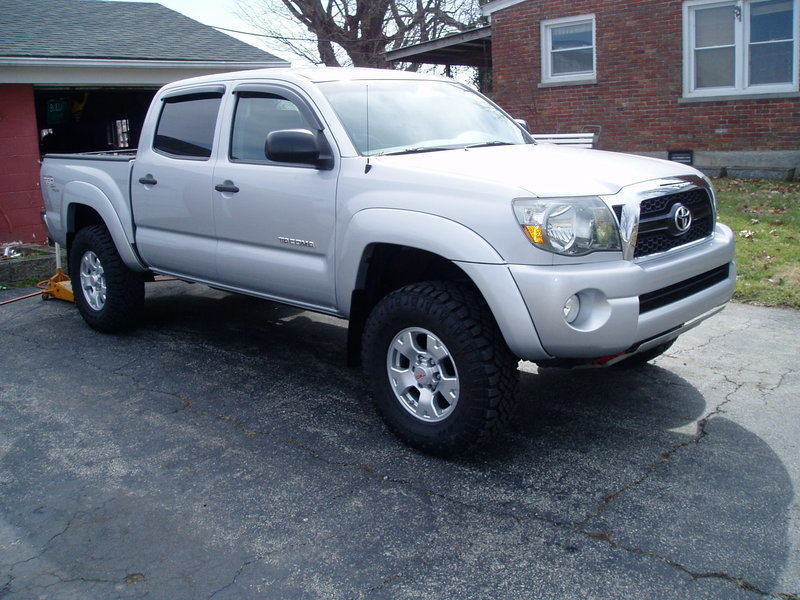

    Bluegrass Taco
    Bluegrass Taco Politically incorrect low tech redneck
    Jul 27, 2015
    #160391
    23,101
    Bill
    Mt Washington Ky
    2011 DCSB, TRD OR, 5100's, 885's 285/75r16 Cooper STT PROs.
    I started out with a stock truck. (2011 DCSB TRD OR) @ 40-something thousand miles, I installed a Toytech Boss kit. It was "slightly used". Come to find out, previous owner had tampered with the shocks. They almost immediately started leaking. So off they came....I had a 2-1/2" top plate spacer lift kit sitting on my work bench that came off a customers truck. I put it on for a while. The truck rode INDETICAL to what it did "stock", just a little higher. By the time I reached 83,000 miles, the stock OR Bilsteins were starting to wear down. The ride was getting a little harsh. So....I called Marie @ Headstrong Offroad, ordered a set of 4 Bilsteins 5100's, OME 885X coils, had them pre-assembled, included a 1/4" spacer, and Deavers 2" AAL (until I could afford Dakars at a later date.) When installing, I found I needed 1/2" spacer on drivers side to get level side to side. I make my own spacers out of 1/2" poly. That set up has been on the truck for a little over 2000 miles now.
    It's going to stay that way indefinitely.
    Ride quality is the best I've ever experienced in a 4wd. (I'm on my 17th 4wd since I got my first one in 1972/4th Tacoma) Stock hub center to fender front end measurement was 20" when stock. After allowing some time to settle, front end measures 22-7/8" now. So the lift is what I wanted. I got excellent alignment numbers with stock UCA's. The truck drives far better than it did stock. On and off road performance is all I could hope for. No tire rub before or after lift. (265/75/r16 lrC Goodyear Duratrac's.) I do have 1" Bora wheel spacers, but those were to get a wider stance, not due to any rubbing issues.
    Deavers AAL gave me far better load carrying capacity that I expected. These trucks aren't exactly "heavy haulers" to begin with......So my expectations there are reasonable. With the slightly stiffer rear suspension, the balance is great between front and rear. Rear end sits about 3/4" higher than front at "static" position.
    Price from Headstrong knocked it out of the park!
    Long story short, I got an excellent ride, the looks I was after, the performance I'd hoped for, and at a very good pricenewlift 002.jpg newlift 003.jpg
