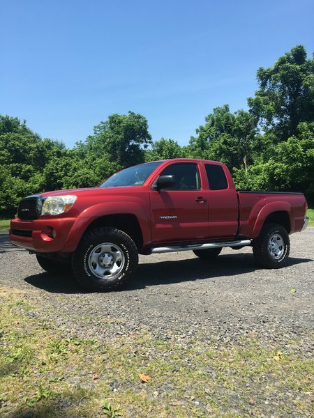

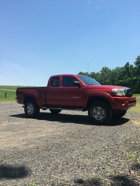

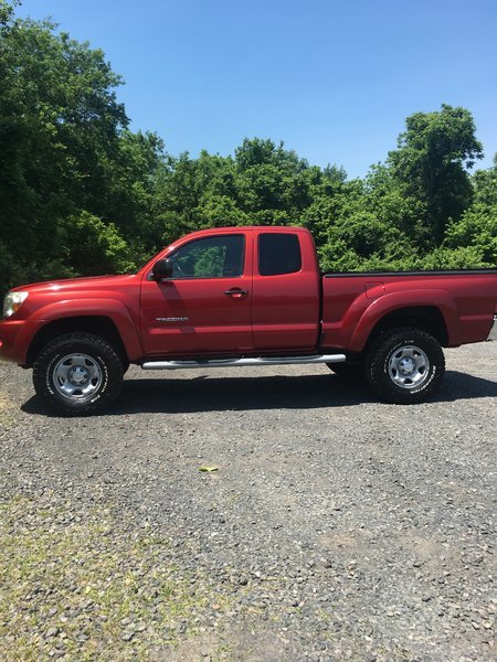

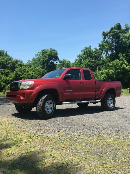

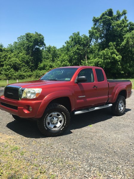

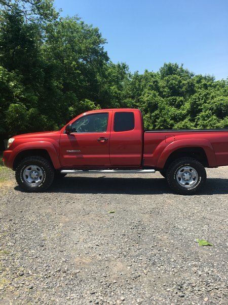

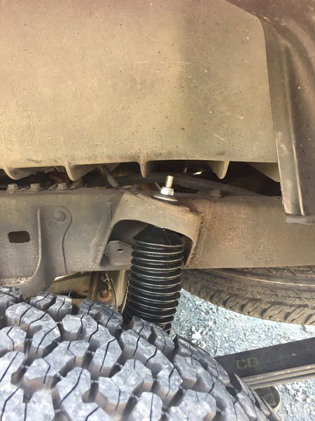

    Above is the rear Billstein 5100 shock, and also the 1" rear aal
    (hard to see it was really bright out)

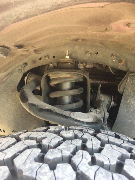

    Below is the front Billstein 5100 adjustable shock, set at the top
    notch at 2.25 inch. stock uca and coil springs.
    IMG_1217.jpg IMG_1204.jpg IMG_1219.jpg IMG_1212.jpg IMG_1227.jpg IMG_1213.jpg IMG_1222.jpg IMG_1223.jpg IMG_1214.jpg IMG_1210.jpg IMG_1215.jpg

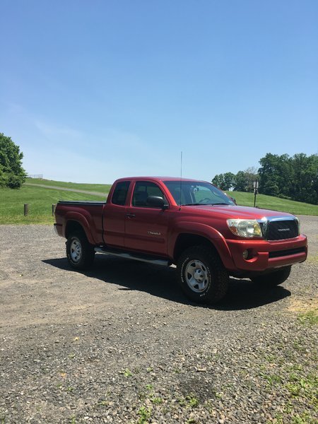

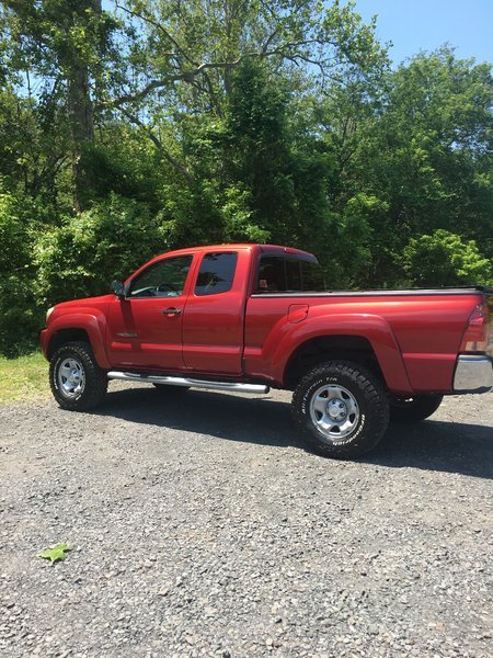

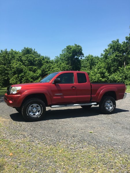

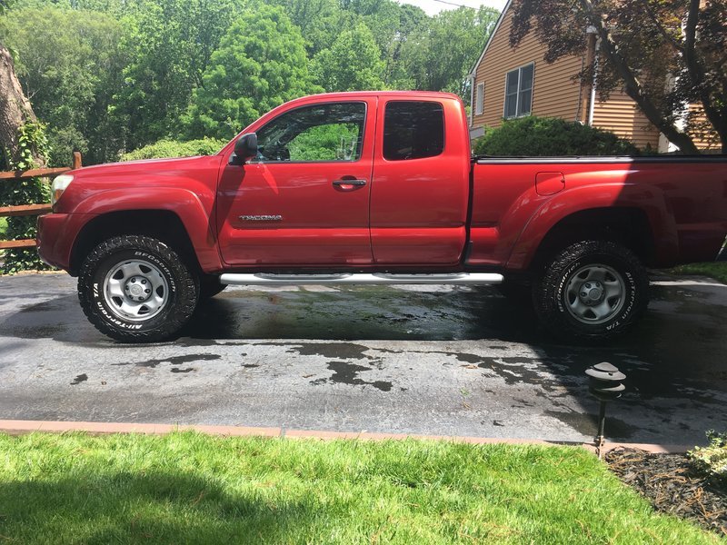

    Hello all, I've been wanting to do this since I've gotten the truck a couple months back, FINALLY! i'm so happy with the outcome... I raised her 2 1/4 inch with Billstein 5100 adjustable shocks set at the top notch. also new shocks in the rear, as well as a 1" aal in the rear to even her out.. Stock springs still, sitting on 265/75/16 bfg a/t's. It rides much better than stock height, its definitely stiffer but it takes bumps and holes like a champ when I'm driving through the city (Baltimore) streets are hella fucked. anyway heres how she looks now.
