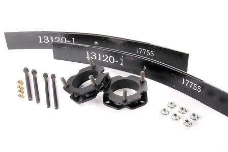

    This looks like the way to go for me. Just enough lift without making the stock tires look bad. Plus add a little capacity to the truck and screw the TSB. The price is cheap enough for sure. Any downside to this? I really believe that a 3" lift will make my stock tires a little bit out of place.

    I'm certainly not an expert, but research the quality of the material being used.

    I know the "price is right" but try and keep away from a spacer lift.;) I mean come on bro, this is your Tacoma we are talking about!!!!:eek:

    There's nothing wrong with that lift. Quite a few folks are using that with no problems. There's also nothing wrong with a top mount spacer. Matter of fact, everybody talks about Bilsteins but they're nothing more than a spacer lift themselves.

    Top plate spacers can damage ball joints, and shocks. They lengthen the shock/spring assembly wich can cuase the shock to over extend, and will over stress the ball joint. Your correct on the 5100's, but they are valved for the preloaded spring rate.

    ToyTec says their spacer kits don't cause any stress. Are they full of sh#t ???
    This is a copy of their FAQ off their web site................

    If they use a 1.5" top plate spacer, then, Yes, their product is no different than the other top plate spacers that have broken shocks and worn out ball joints.

    There shouldn't be any problems under 3".
