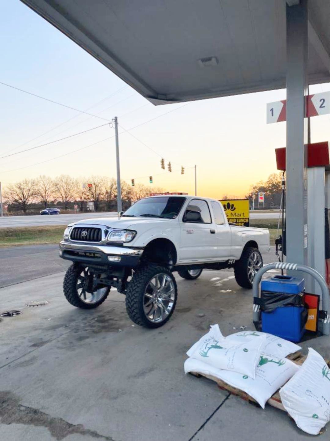

    I did write to a couple of the companies but haven't heard back (probably cuz it's holiday season). In the meantime, do you guys think it's unwise to only get the front lift for now? As I said earlier, I'm contemplating getting front 2inch lift with Bilstein 5100 + emu springs, and only replace the the rear shocks with Bilsteins as well and see how the truck sits/drives like that. Would the back sag too much hauling a dirt bike? it's only 300lb...

    It might look a bit silly when loaded. Something like this:

    Yes, the rear would look sagged even without the load. Some people are into that look, to each their own, it's your truck so really up to you.
