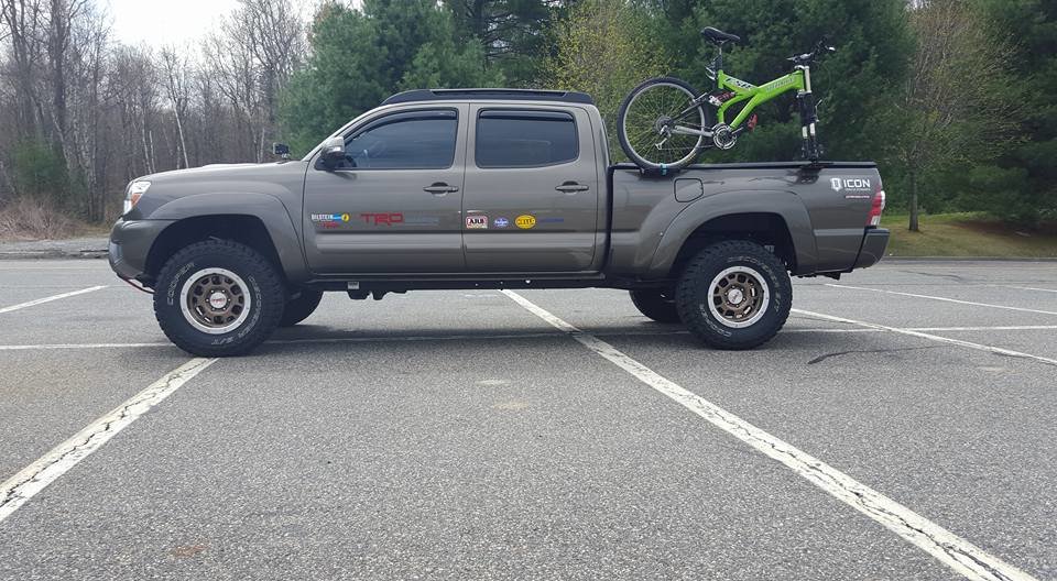

    I have the OME 887's on 5100's up front, and the same 3 leaf in the rear but the ICON version.

    Oh okay, by any chance do you have any pictures so I could see what it looks like?

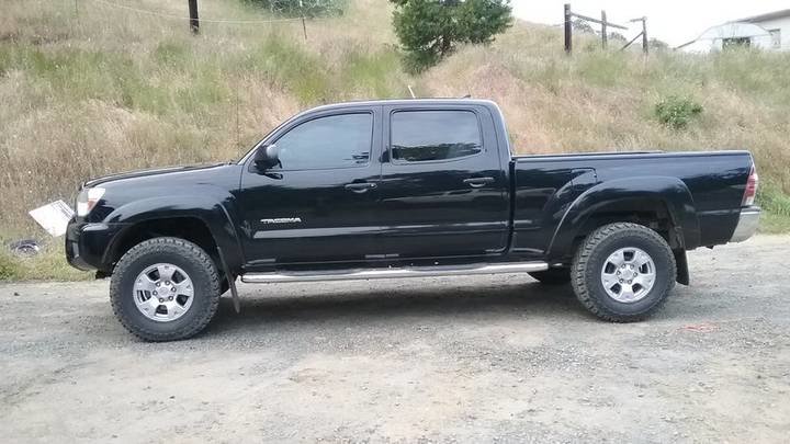

    Heres mine with bilstein set to 2.5 with a 2in add a leaf in the rear and rides fine.

    Unchained 5150, that lift looks really nice. I just want to make sure my tires don't look small after my lift, they're 265/65R18's. What do you think?

    And mlcc, what size tires do you have?

    Mine are 265/75/16

    265/75R16 cooper st maxx
