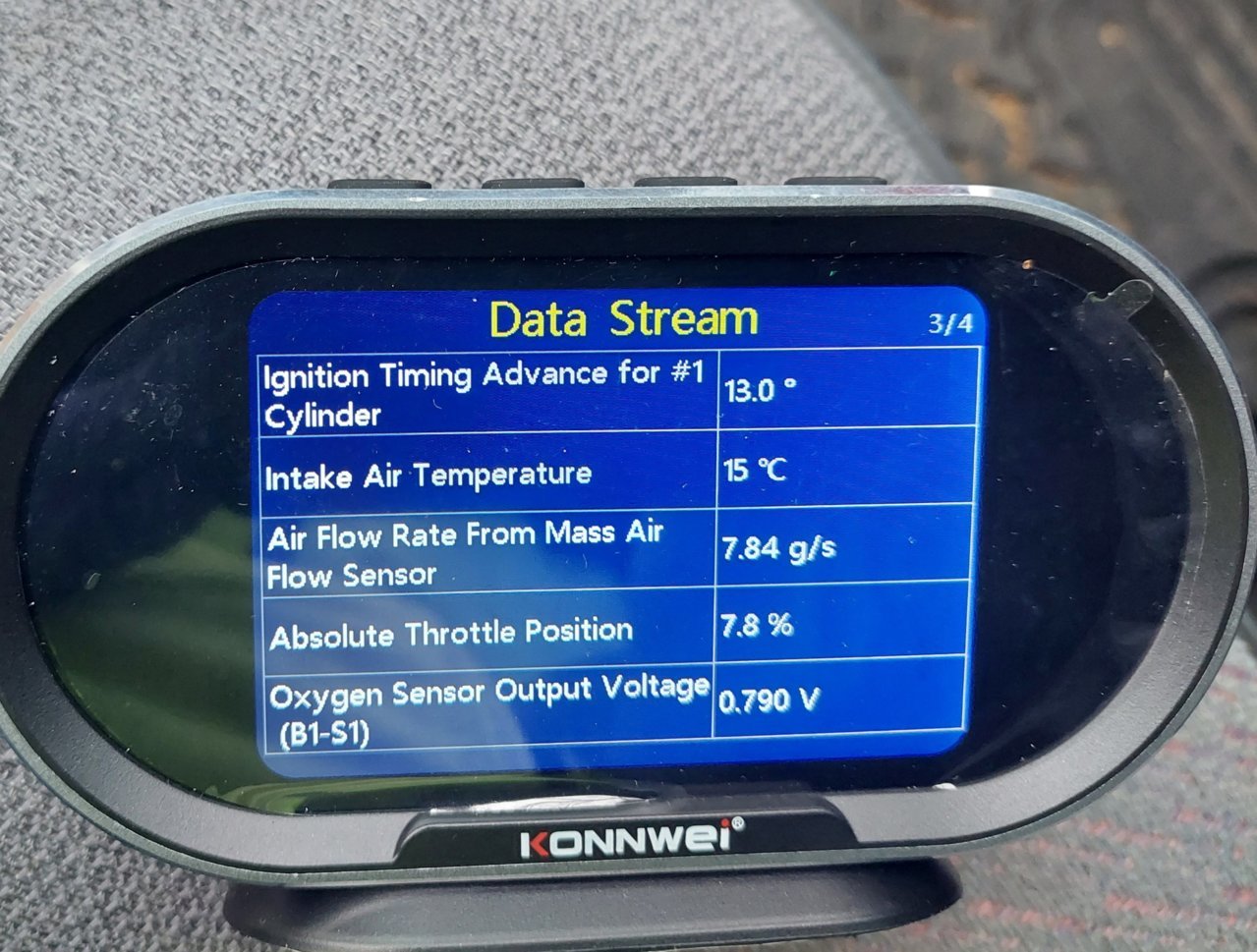

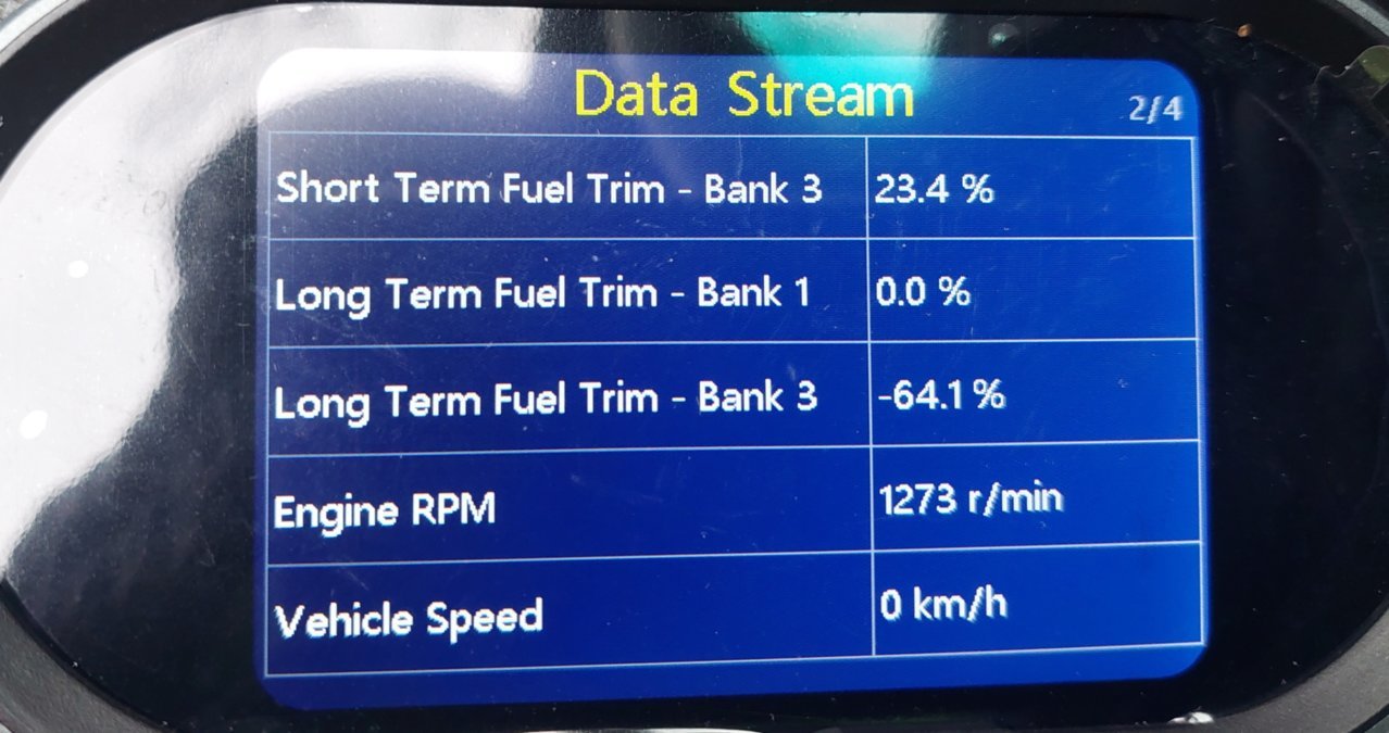

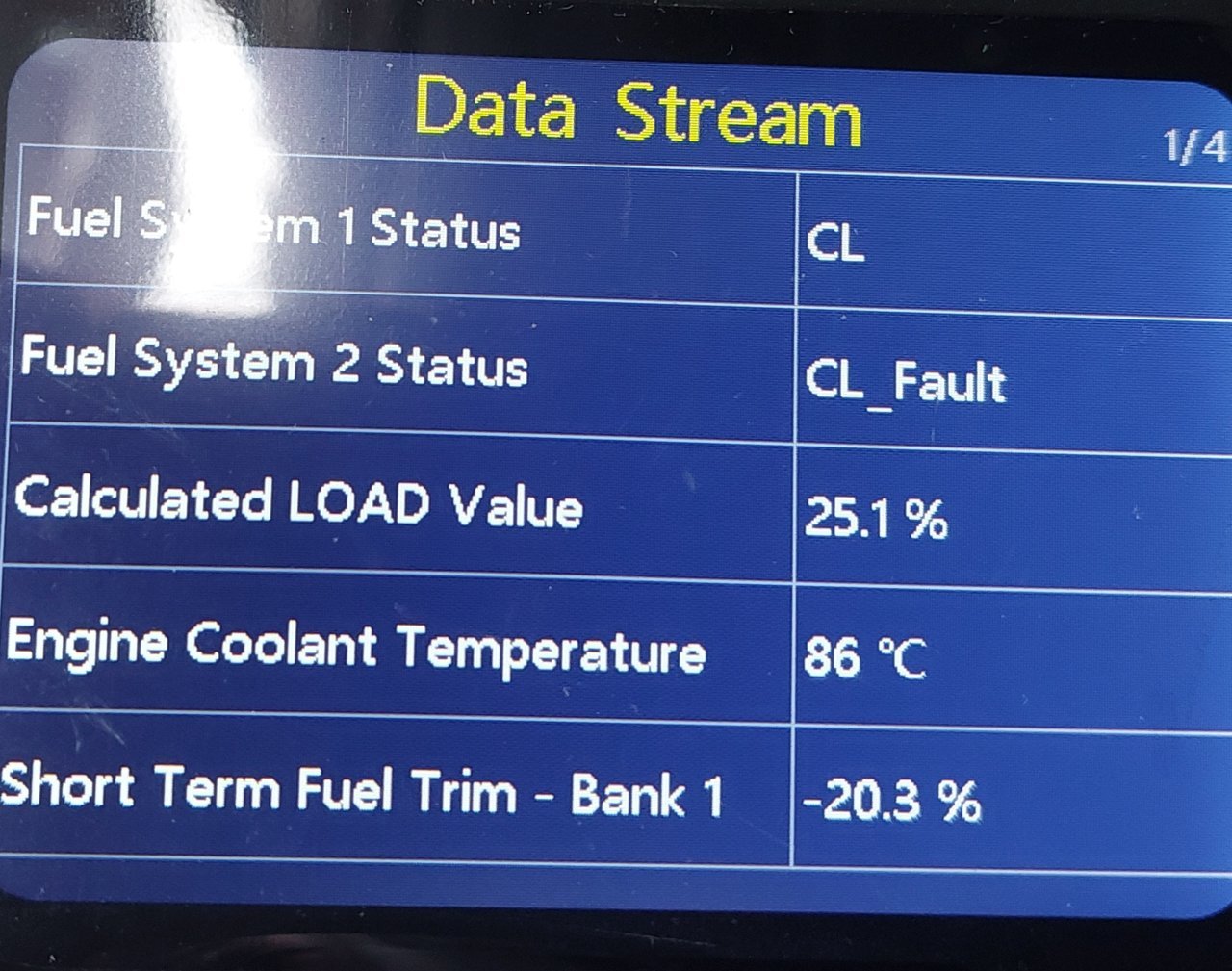

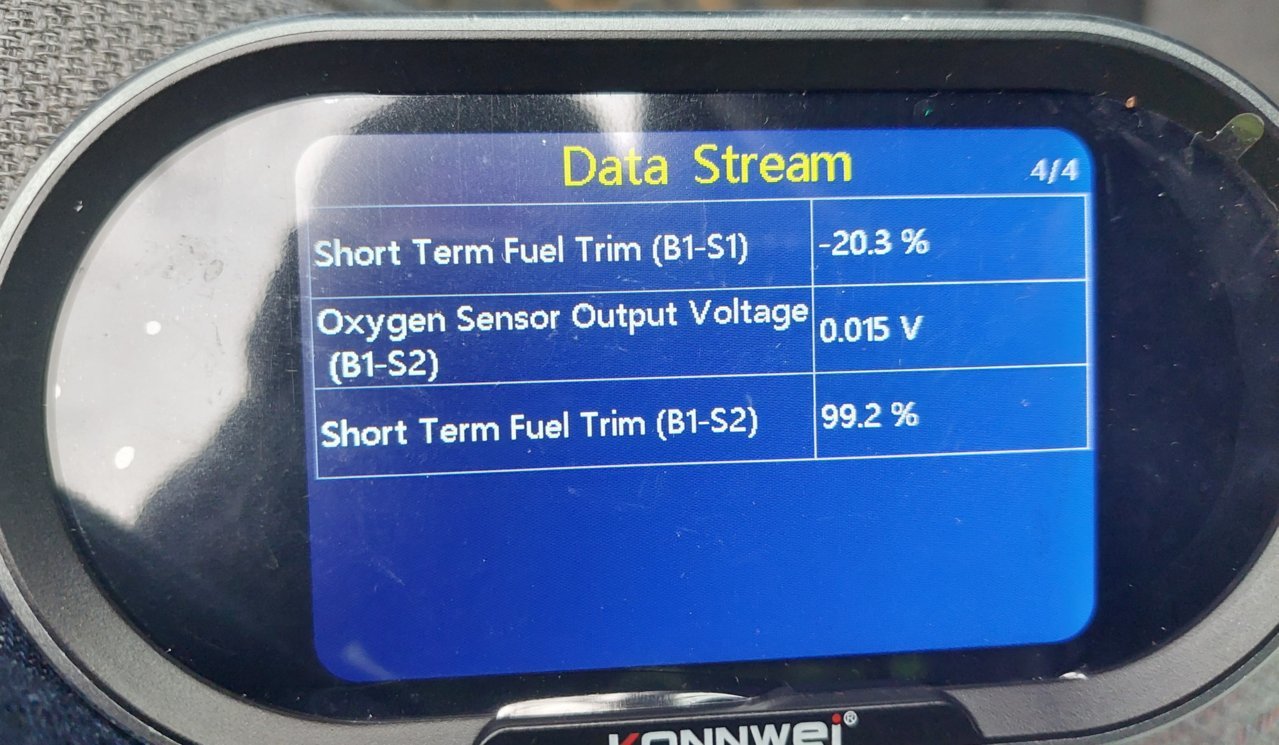

    Here are some pictures from my scanner for what they're worth.

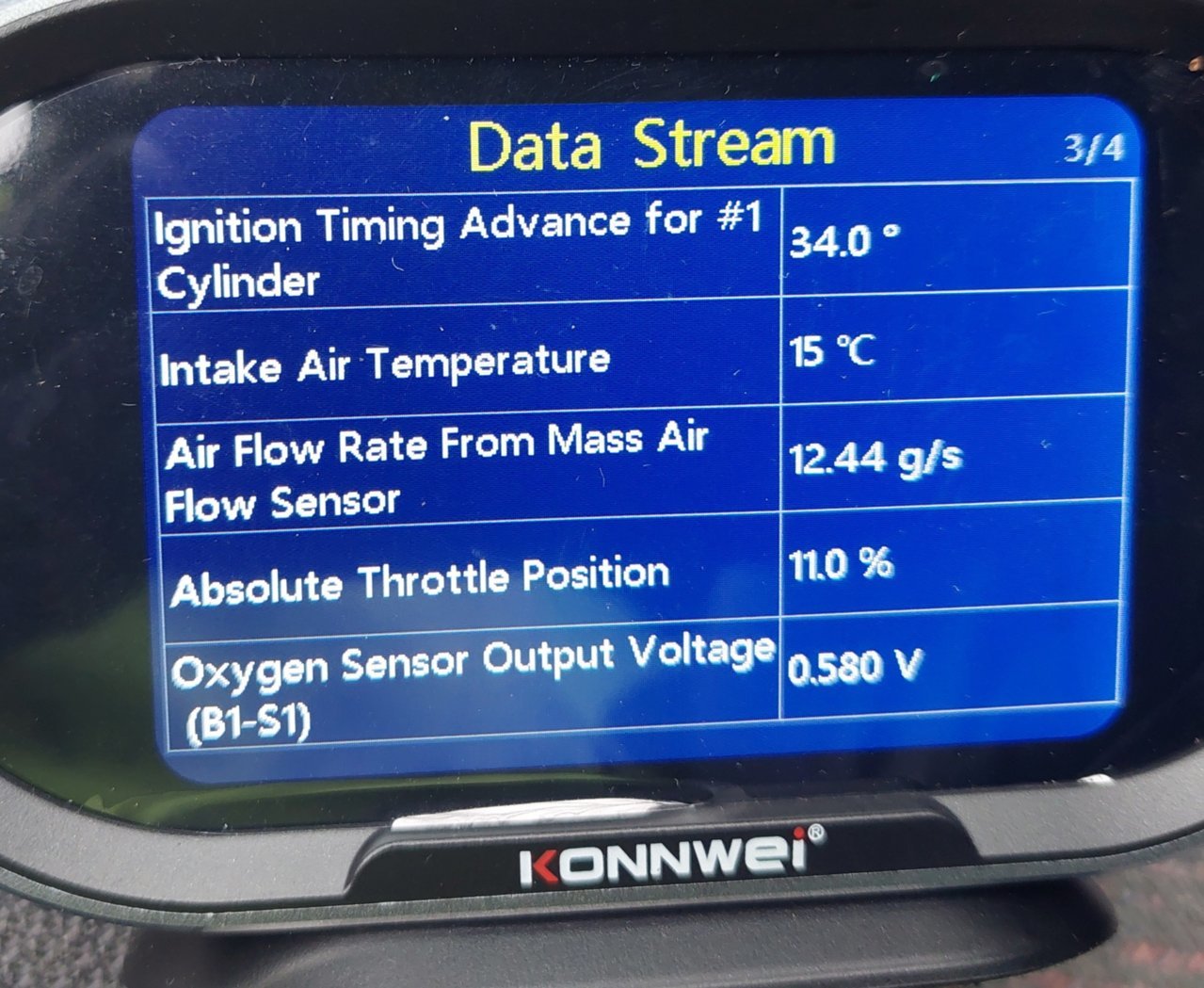

    and timing advance at different RPM's.

    Ground zero would be MAF check.....and/vacuum leaks.....
    thats about 75% probs here......pcv valve leak ect....
    Next easiest to check......check all around you injector cups...
    make sure those cups are right....
    Its all a process of elimination...
    days of retarding ignition are over.....that went out with carb's.....
    unless you want to spend $1500 on a custom fuel management system...
    NExt I'd venture to the butterfly in the throttle body...
    .....it must close fully at idle.....unless boosted by vac from steering, tranny, or a/c controlled switches.....all possible trouble spots....
    Its not common to get a leak at the intake gasket....but never know....
