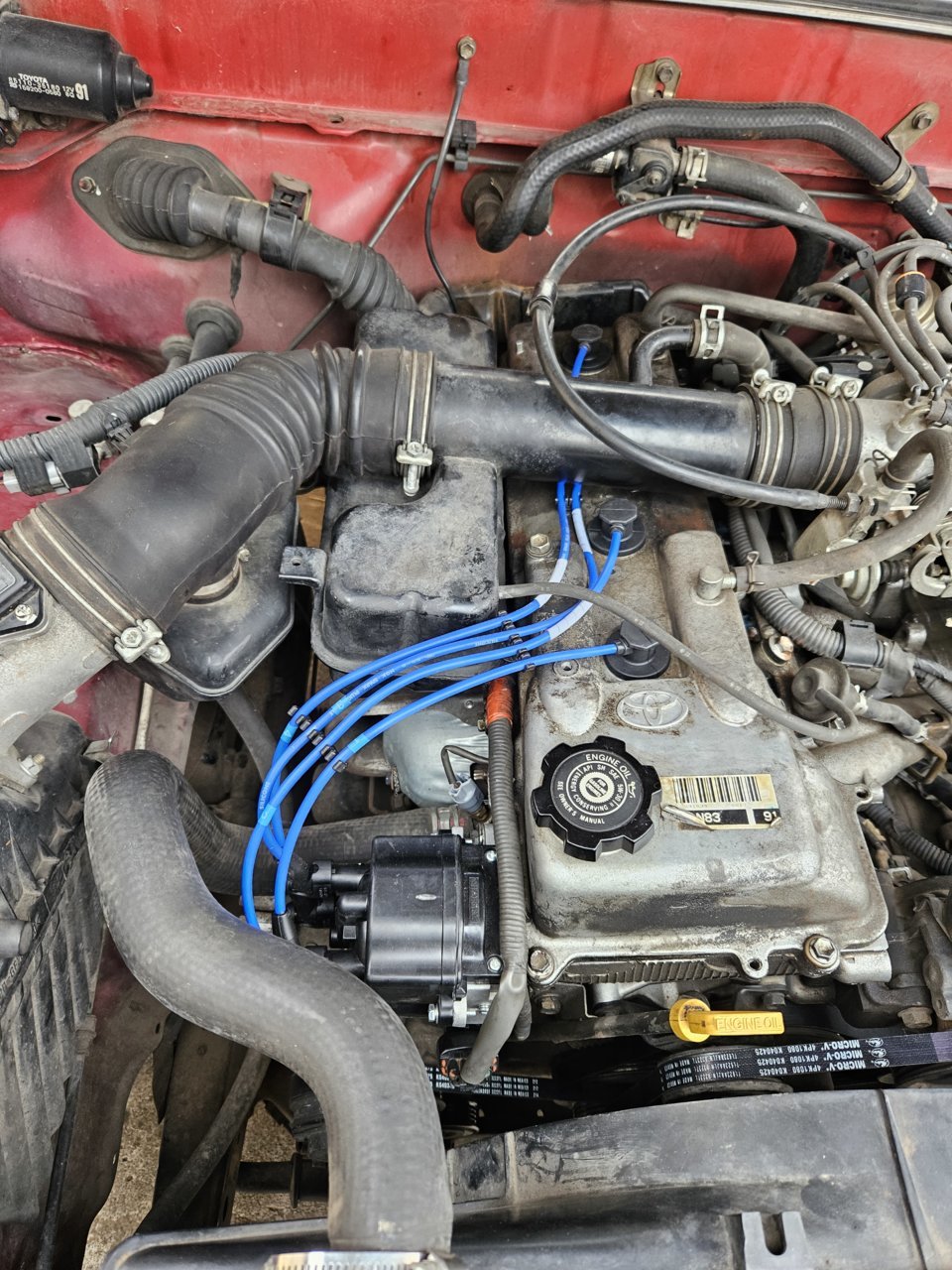

    I was wondering if anyone knows of and where I could get an aftermarket intake pipe so I can be rid of these extra chambers and space from my stock intake? I know there's K&N and (I think) Injen make them. However I'm not interested in those (at least not yet) as I just want to replace the pipe and use my stock Mass Air Flow and intake filter for now.
    Thank you for any help and replies!
    (Picture is of my intake for reference/ help)

    Spectre has a plethora of pipe pieces. Good luck

    Thank you. I forgot about spectre. I think the one I saw on another 2.4l like mine was an AEM. Still... best bet, I should probably save up and just get one of the kits. Unless I can find someone locally who can bend/custom up and aluminum pipe and just make a custom one. I did that for a Toyota Celica I owned once. I appreciate all of the help, and any more suggestions or help others may bring. Thank you.

    I was thinking the same
    But will be the kid’s taco
    124HP is fine for 16yr old
    I have a crap ton of 3inch aluminum intake piping from older Subaru/Honda projects
    I would guess pretty easy
    2 straight pieces
    one silicone elbow
    2 silicone connectors to MAF sensor housing and TB intake
    I would try to support with bracket of some kind too
    would definitely ‘smooth’ out airflow into TB
