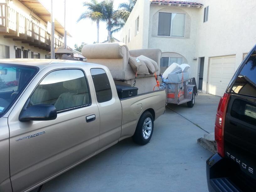

    The 6x12 was fine. We loaded it up as you can see and I had no issues. I distributed it well and drove 55 mph like uhaul suggests. The surge brakes on the trailer help too.

    Doesn't look like you got 1500 lb worth of cargo in there. :)
