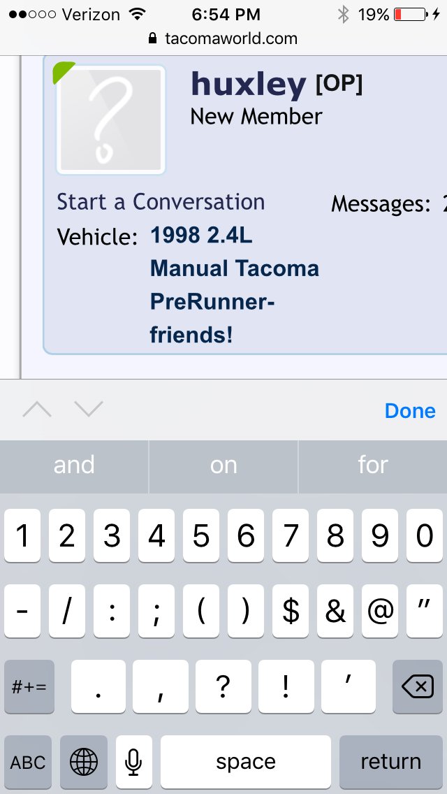

    A PreRunner would have a 2.7L engine...?
  6. May 4, 2019 at 3:52 PM
    Kwikvette
    Feb 27, 2019
    #284735
    80,278
    Fresno County
    4 run, 2 don't
    2.4 is found on 5 lugs.
    2.7 is found on 6 lugs.
    Don't see where anyone mentioned a Prerunner anywhere, though I do see the OP's signature...pretty sure he's just unaware of the trim models as it's not his truck.
  7. May 4, 2019 at 3:54 PM
    PennSilverTaco
    PennSilverTaco Encyclopedia of useless information...
    Jul 15, 2014
    #134007
    71,510
    Charlie
    Central Bucks, Pennsylvania
    2010 Zombie Truck 2002 PT Cruiser
    Look at OP's personal info...
    Kwikvette[QUOTED] likes this.

    The rear gate says PreRunner though I imagine that could have come off a different truck at some point, this thing has been well loved (and now abused).
    It is most definitely a 2.4L engine. Apologies for the confusion there.
