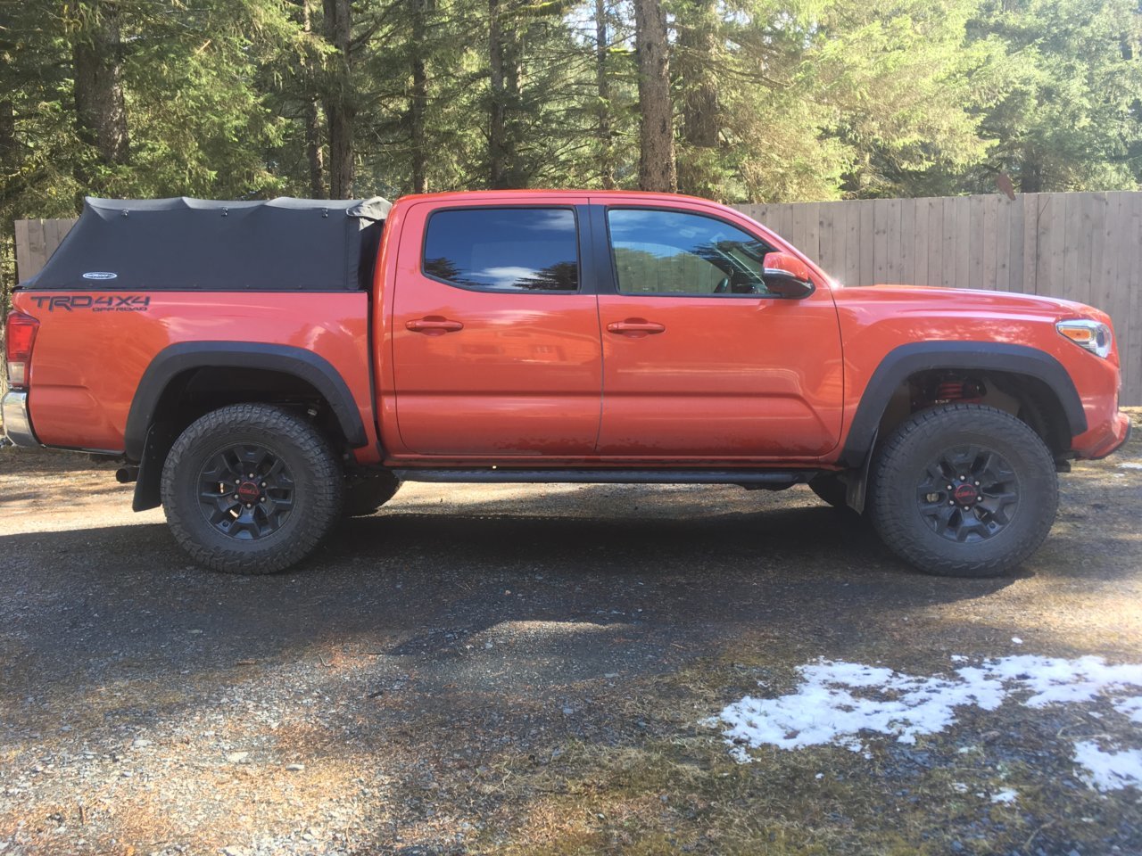

    I will get this tomorrow if I can. Here is one that I took but is farther away. Just installed jba uca a few days before lift. I have appt. for alignment on Tues. I have to drive 150 miles just for alignment so hope that’s ok. F2097DF7-F2A1-4608-9415-AEAC04F9189A.jpg

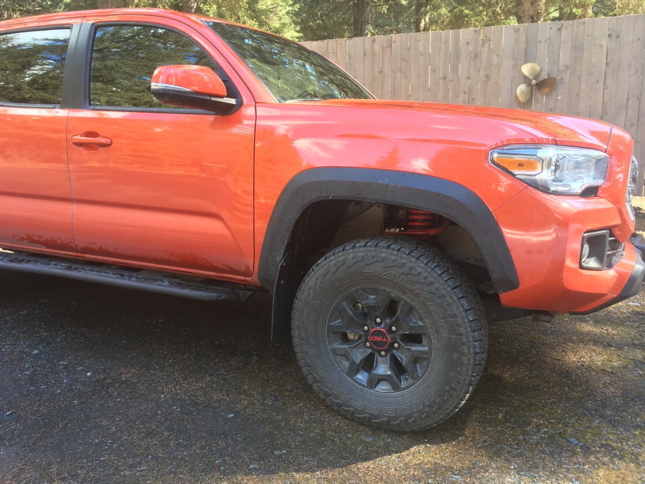

  15. Apr 20, 2019 at 10:38 PM
    JARStacoma
    JARStacoma [OP] Well-Known Member
    May 8, 2017
    #218524
    652
    Alaska
    17' inferno TRD OR MT
    B1FDFD92-A466-4B87-86DE-310F190DF3B8.jpg As it sits here I am at 22.5 center hub to fender on rear with a 1.5” 3 lead aal from headstrong with ol taken out and in front I am at 22 dead on both sides. I am beginning to feel that the 21” stock height measurements are taken from bottom of center cap because that is exactly 2.5” lift. However if this is the case I should be level to the rear. I’m totally confused at this point.
    Also on 265/75/16

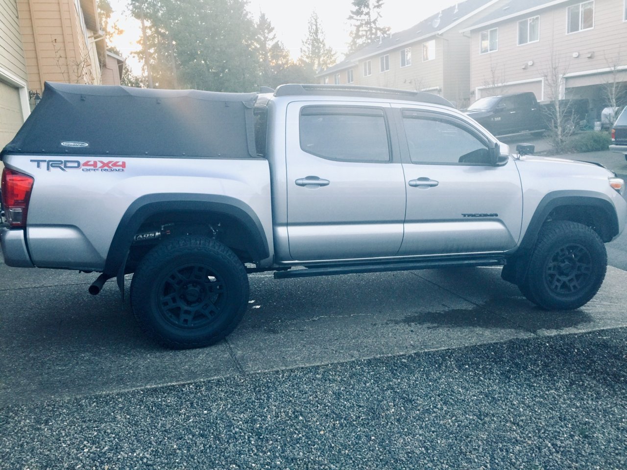

    That looks almost exactly like my truck and I’m sitting at exactly 2” (ideal)
    I think it looks great!
    My pic angle is weird, but
    265/70/17
    71tattooguy and (deleted member) like this.
