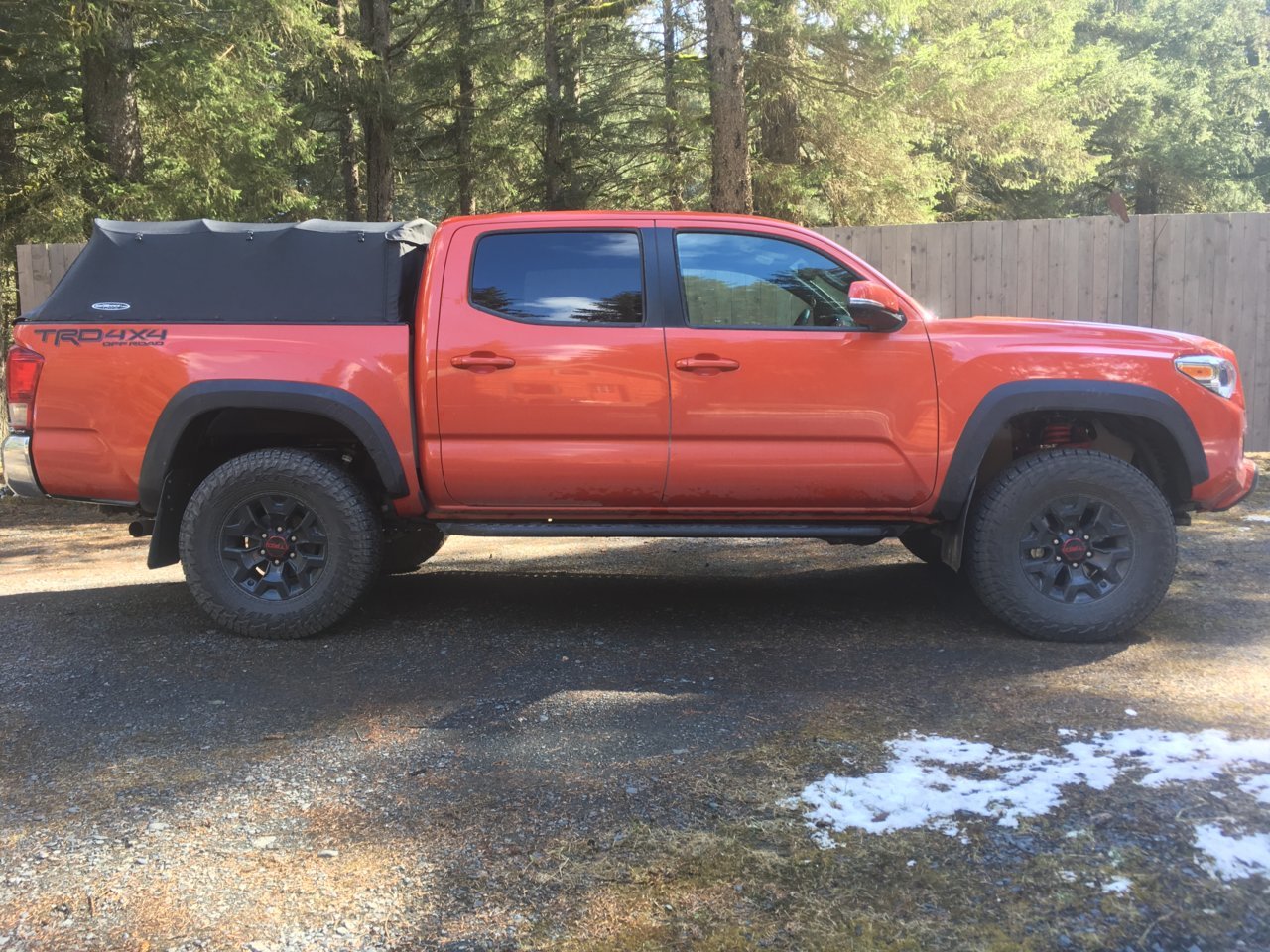

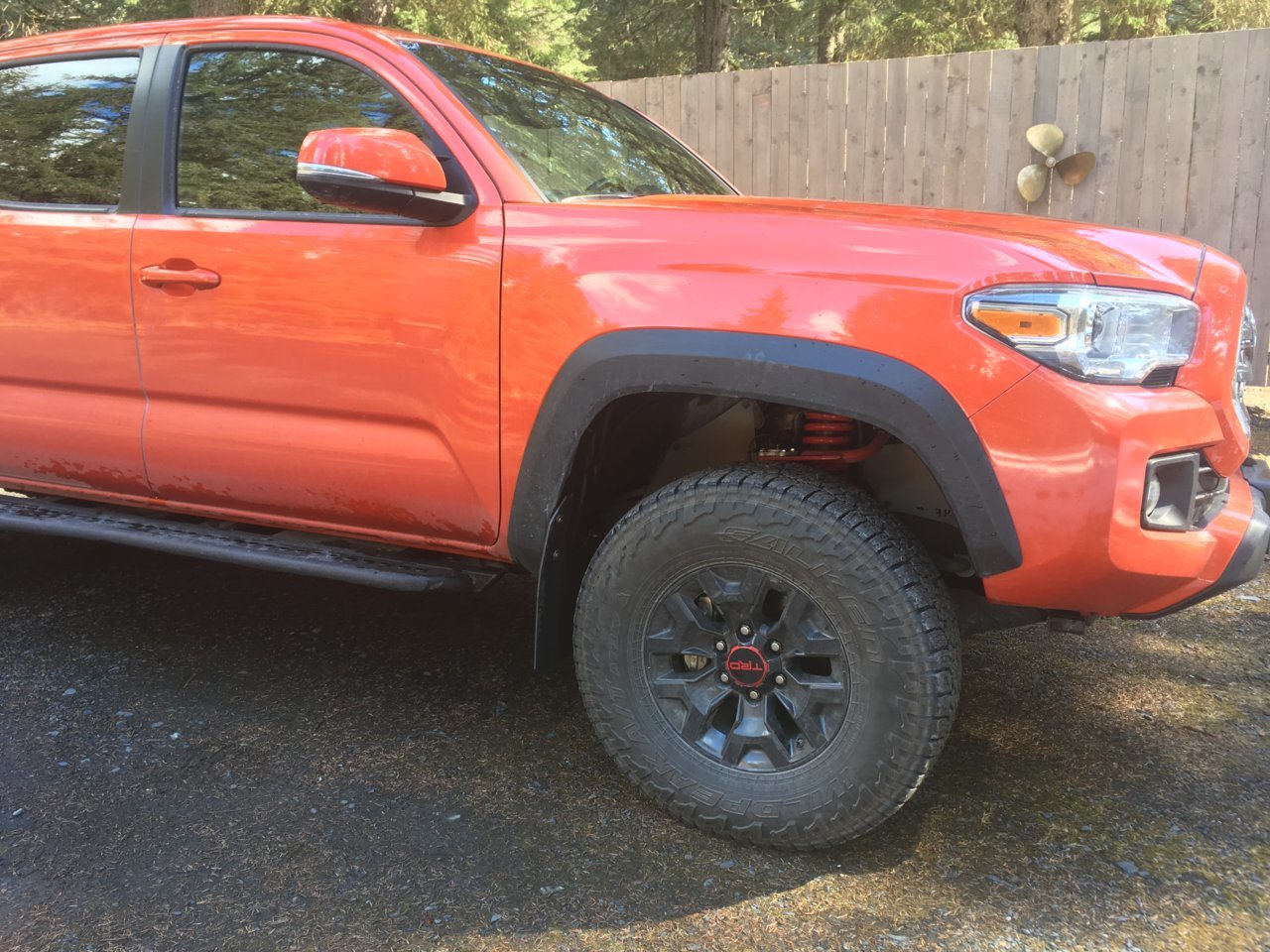

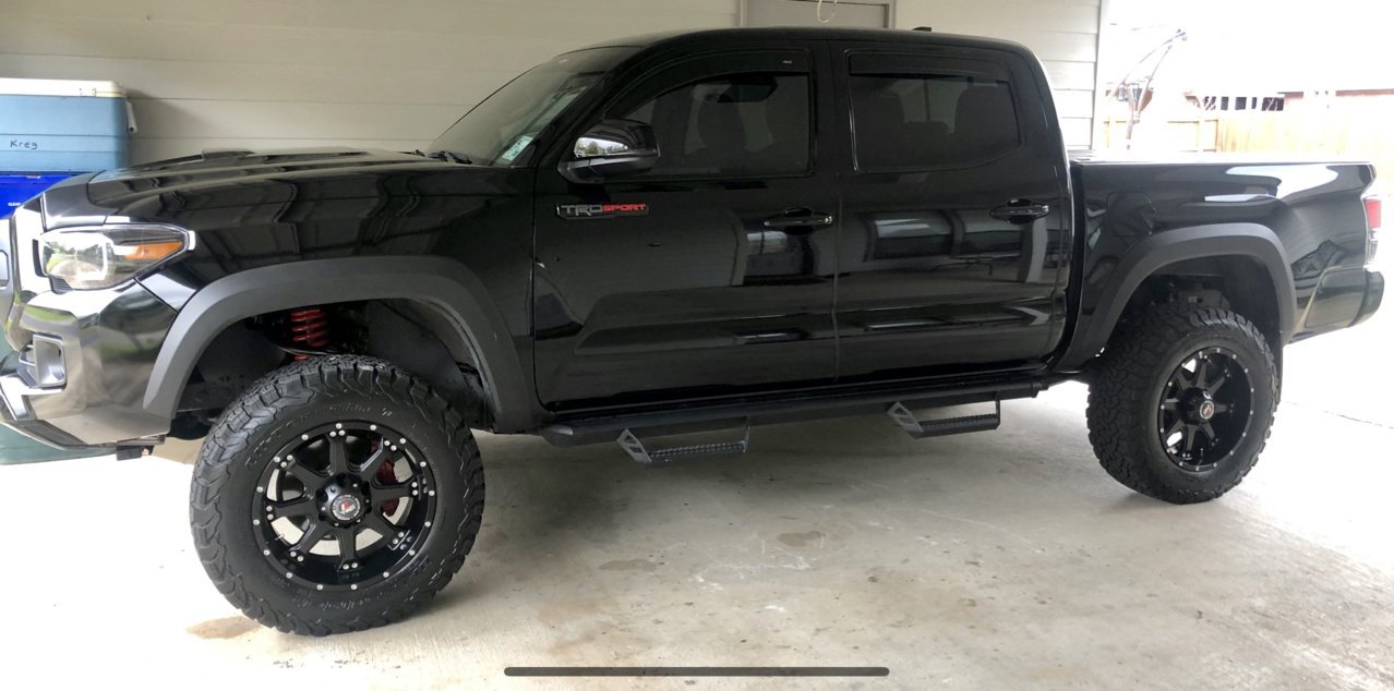

    799271CB-30A5-441E-8AC2-460D43415009.jpg These are 265/75/16
    Rodger that. There must be some variance because I am at 22” and I def. have more than 1” up front I would think. Also I have a 3 leaf aal from headstrong with OL taken out in rear. Rated for 1.5” lift and my rear is at 22.5” so I am sure that those aal’s gave me more than .5 inch since the whole 3 pack is at least 1” thick.

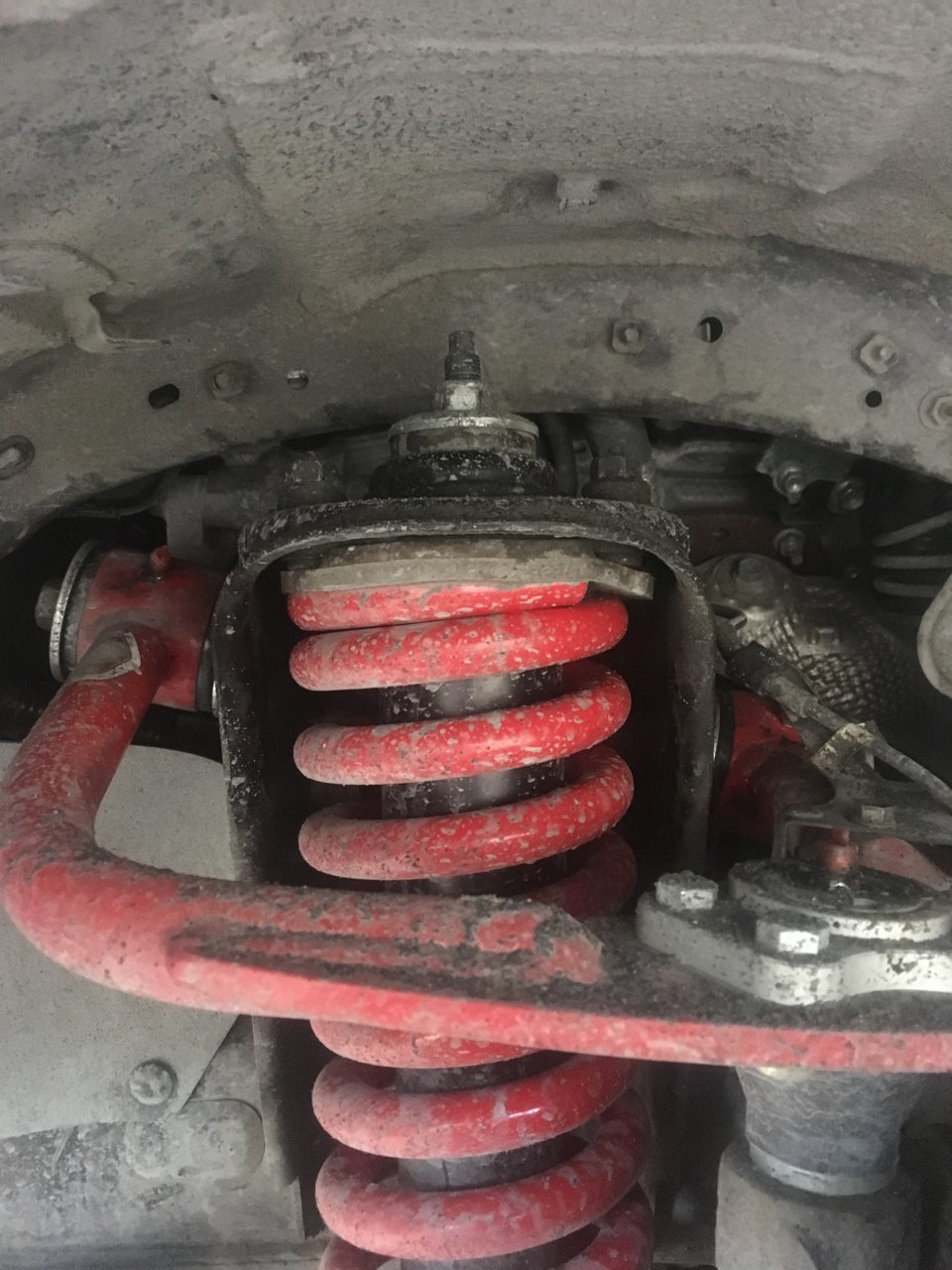

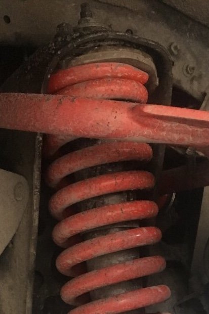

    F13F9031-9D1E-40E5-9360-FD10DA5AFF56.jpg 2E844CDA-65DC-45A5-B569-CC60DCB56751.jpg They almost seem over compressed?? I had them fully compressed with my floor jack while I torqued my LCA cam bolts. I guess this was not proper procedure??

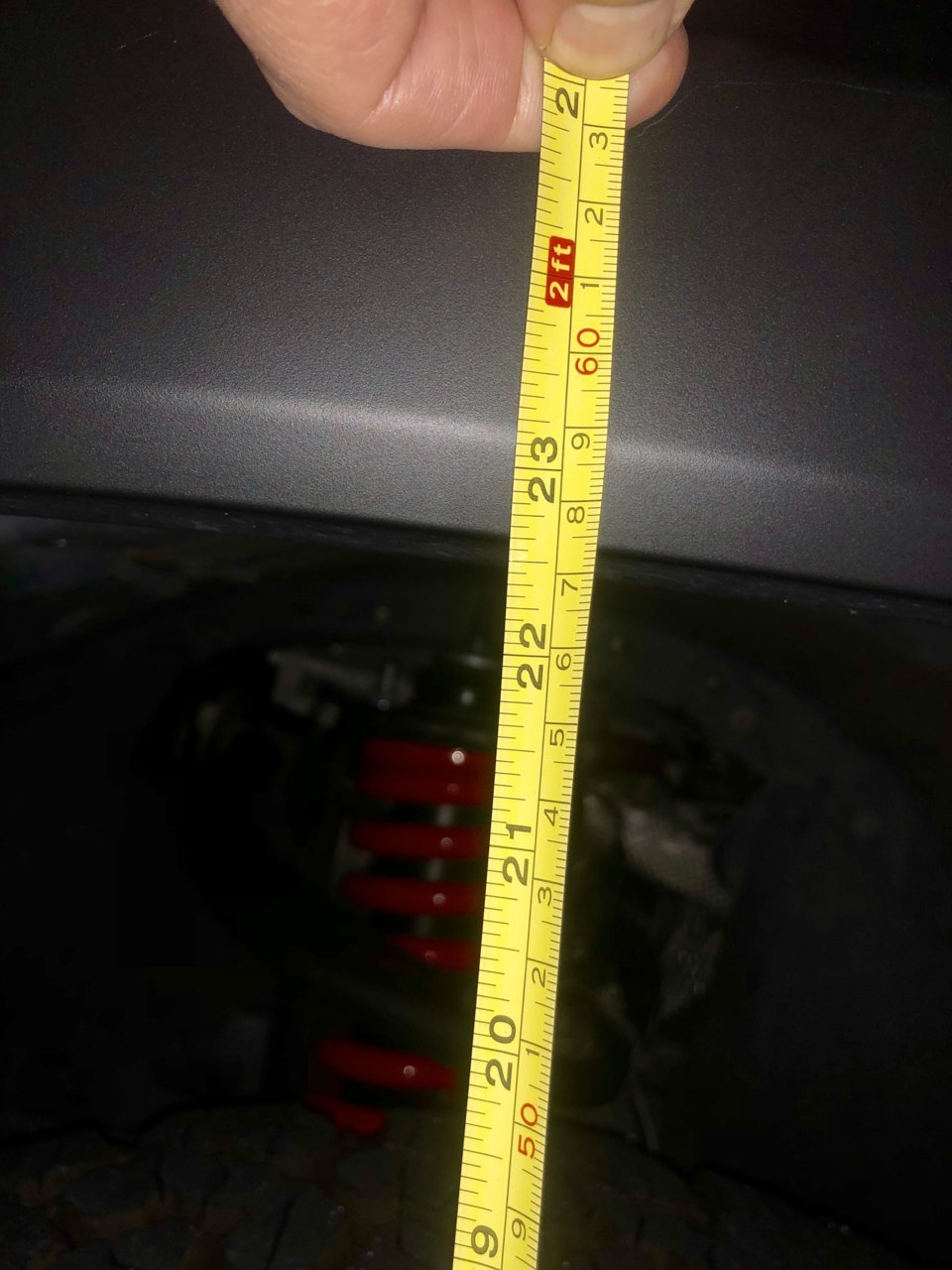

    I also have Dobinson’s 314 coils. Just went outside and measured center hub to fender—22.5”. Ground to fender—38”
    Stock UCA’s, no extra front weight. 275/65/18 (32”) tires.
    From my calculations 2.5” of lift.
    617299D4-C93E-4D34-B2D3-E4EDE1BEA162.jpg 939777BD-39F1-446C-A3E6-4945CCF672EF.jpg

    Something is up with the top pic. The coil is sitting weird and causing a weird bow to it. Is the coil the right side up (if it matters)?
    The top rubber spacer is kinked funny and unless my eyes are playing tricks the spring is not straight vertically and has unsymmetrical spacing around the shock

    GTS Dobinson's lift, 33"-Wildpeak Atw3-18x9 -6 Offset ,265/70/18 tires, Raceline Assault wheels, Backflip G2 bed cover, Magnaflow exhaust, Pro tail lights, Pro fog lights, Pro grille, Raptor grille lights, Predator side steps, RedLine Hood Struts, Toyota bedmat, tinted windows, Retrofitted-BHLM-Amber Halo-Amber DRL-HID headlights, LED Highbeams, LED Hood Scoop lightbar, LED hidden bumper lightbar, LED under hood light, LED Bed lights, LED license plate lights, Tacoma tailgate 3d letters, Tacoma glovebox 3D letters, removed air dam, Custom TRD Sport emblems, Pro Shift Knob with Meso ECT Stealth button, Meso LED dome and map lights, Meso V3 smoked mirror turn signals, Meso Stage 2 Tail lights, Meso Mirror Puddle lights, Meso KC-5 Brake/Cargo light, Meso center console bucket with OG lid, Tailgate PNP kit, Garage door opener button in overhead console, Meso Minimalist keyfobs, Matte black Pro hood decal, KTJO4x4 Led door handle LED lights, Pioneer 6x9 3 way front speakers, Rockford Fosgate 6.75' rear speakers, TacoTunes tweeters, AJT black vent rings, JDM Gas cap cover.
    Prior to my suspension, I had a 2/1” spacer lift. I measured ground to fender and it was 37.25”. After putting on the suspension, it was 38 (I gained .75”). So I just assumed it went from 2” with spacer lift to 2.75” with suspension.
    I never measured it stock. And since Dobinson’s claim 2.5-2.75” with the 314 coils (with light or no weight), my before and after measurements made sense to me.
    But if you say it’s only 1.75” from stock, I can’t argue that since I don’t have my stock measurements. But I do know that when I park next to another taco with a “3 inch lift,” we seem to sit level with each other.
