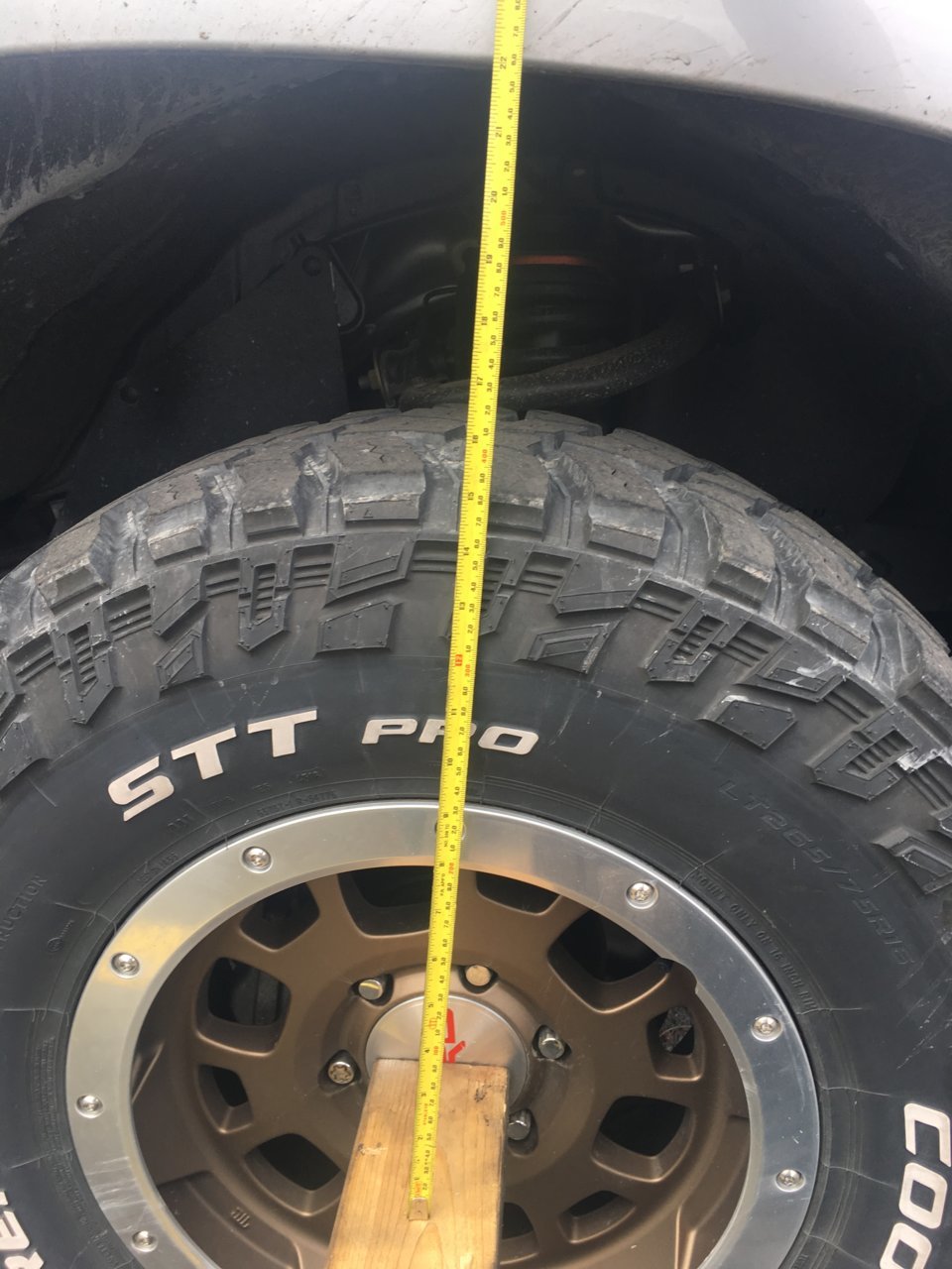

    I saw that when I went to get the pic. It seems bowed but am also wondering if it seems that way because of that isolator pad. Not sure how it got like that as it was perfectly set when I put the coils on. I used the method of decompressing the coil with my floor jack and put the new coil over the shock and re-compressed with floor jack. The I re-used the OEM top hat and mount.
    It is right side up. The pig tail is down and turned all the way in it’s correct position. I am starting to think they are being constantly compressed by my LCA.

    @PapaRee thanks for chiming in. I am confused as well if this center hub to fender measurement with stock being 21”. I would say that you are def sitting higher than 1.75” just from your pick. Stock rear is supposed to be 22”. If measure from literally dead cent cap, This would mean that my 3leaf AAL from headstrong only gave me 1/2” lift in the rear as well which just is not possible since the pack itself is at least an inch taller. If I take my measurements from the bottom lip of center cap than all these measurements make sense. I know that I am trying to get these numbers squared away and figure out my suspension but things just are not adding up. I know for certain that I am more than an inch higher in the front from stock where I sit now but when I measure from dead center cap I get 22”, bottom of cap I get 23.5. Looking at your truck u def seem higher than 1.75.

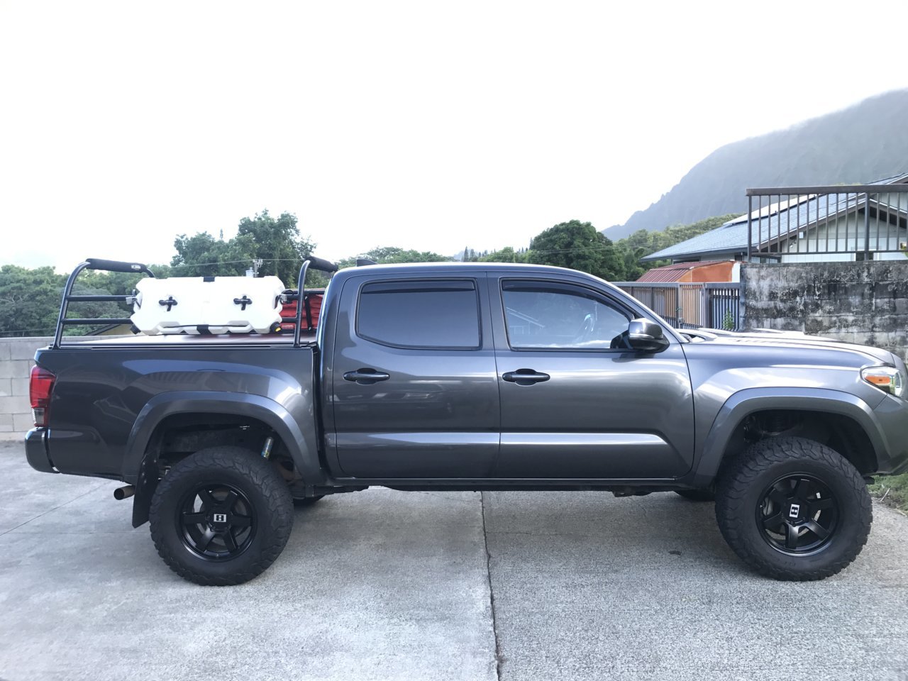

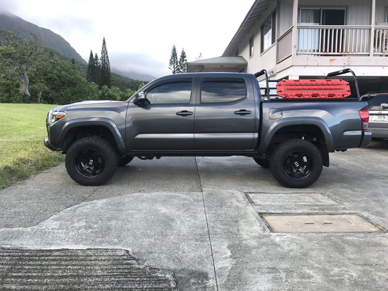

    I didn’t add anything to the rear, I wanted to preserve as much of the factory driveline angles as possible, and it turned out the spacers were not only the least expensive, but the least invasive on the geo.
    This is all I got on the phone after a photo purge.

    Thank you. I would say it looks pretty good for a 1/2” spacer. Appreciate the come back.

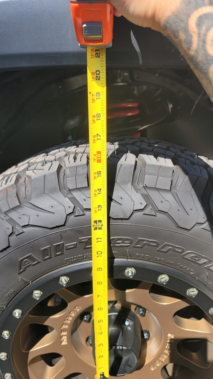

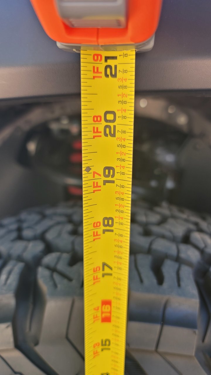

    I'm wondering if the TRD OR is stock 21" from hub to fender.
    Why is my TRD Pro 20.5 from hub to fender
    Am I doing something wrong or is something wrong with my fox suspension?

    My trdor was 20.5 in the front as well. Just varies with each truck.
