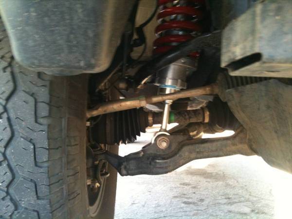

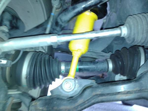

    heres a shot of my CVs now...
    And here is the rake I got going on....sits too low in the front

    Here are mine with between 2.5 and 2.75 inches of lift. Originally truck was a TRD Sport, now truck has OME suspension with 886 coils.

    Thanks for the reply. Do you have a aftermarket front bumper with those 886 springs... I thought the 886 would give about 3" and the 885 are around 2.5".
    Also did you extend the boot by loosing the clip and pulling the boot over a little then re-tighten?
    After seeing that pic I think I might go with the thick 3/4" lift spacer on the drivers side and a smaller trim spacer 1/2" lift on the pass side. There's a 1/2" difference from my taco lean...
    I was originally gonna just run the 884 s and the thicker spacers and get 3/4" on both sides, but that pic above is alittle too much angle for my liking...

    The pictures I provided are for a DCLB without front bumper or winch. But it does have a full set of ATO skid plates and sliders which add some weight. The lift was much closer to 2.75" than 2.5".
    I did not perform the CV boot extension mod. The angles have not cause any problems yet after 5,000 miles, but I clean them off after off-roading and give it the occasional spray of protectant. Believe it or not, the fins don't actually touch, but it's close to the limit of what I would be comfortable with for long CV life. From casual observation, I have not seen any real wear on the boots since installing the lift.

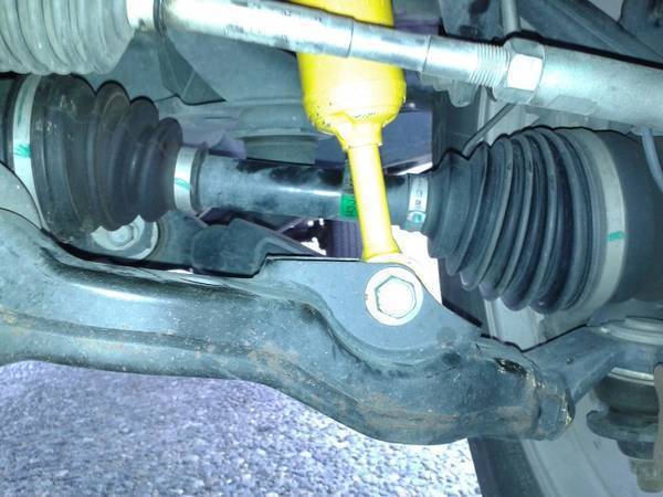

    cv angles aren't what you're worried about with around a 3" lift, they'll be just fine. it's your ball joints on the uca's that pose the biggest worry point cause they have limited movement on the stock uca's. i'm running just over 3" lift in the front (w/diff drop from toytec) and ended up with just over 3.5" in the rear with the ome dakar leaf pack, no drama's over here though i do plan on upgrading my uca's in the future

    set at just over 3" of lift

    Nice- those CV's don't look bad at all. My friend also sent me a pic of his 3" lift and his don't look too bad- he put in the diff drop tho.
