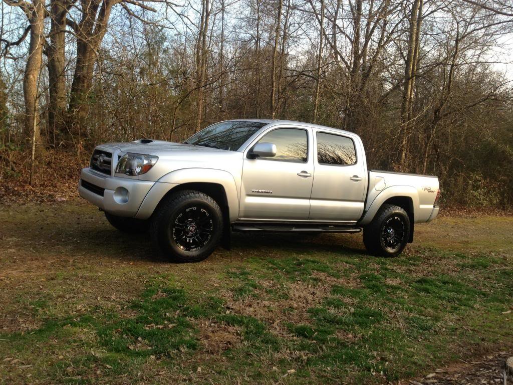

    If it's your DD why not just set the front to 1.75? That will level it out without having to touch the rear. Mine are set to 2.5 and the ride is fine, TSB springs in the rear and it's almost level.
    Whitetrash likes this.

    Nice looking truck! I like the height of it. I measured my truck now and the rear is about 1.5" higher that the front so I am going to order me the front Bilstein's next week and put them on and see where i'm at then. I will probably set it at the 2.5" because I want a little more height to it. If I need to bring the back up an inch I will just put rear Bilstein's on it I guess. I'd rather do that than the 1" block. My 2010 has the 3 leaf springs on rear but according to the TBS, if I read it right, mine should have had a recall also but I never got one. I bought it new later in 2010.
