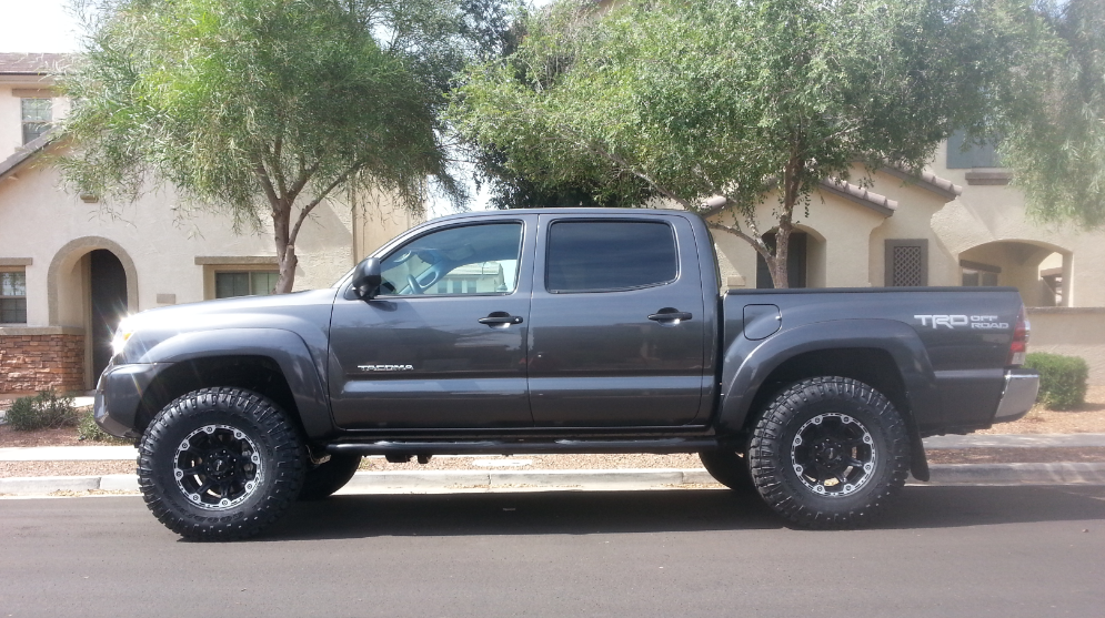

    Correct..set it at .85 setting
  2. Jun 14, 2014 at 11:04 PM
    #42
    Yota64
    Yota64 Professional Threadjacker
    Jun 13, 2011
    #58237
    7,967
    Well good for you! But wait, how did you get 3&5/8" lift with billies at 2.5...?
    Sweet!!
    Is his rear lifted at all? I heard 1.75 to level but I could be wrong

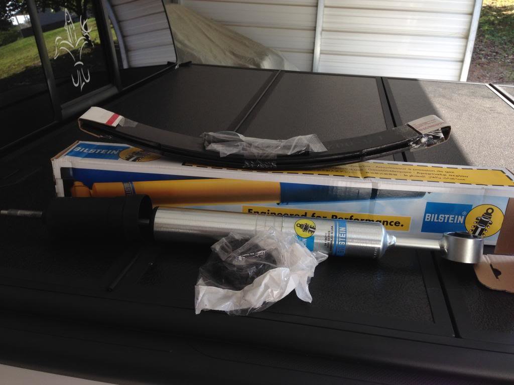

    With a 5100 setup how do you guys recommend lifting the back? I have an AAL and stock leaf pack I'm about to install but they have 50K miles and I'm afraid I'm gonna get a bro lean. This truck will need to last for quite a few years anyway so I would like a permanent option but nothing too expensive. And why are the air bags not more popular?
