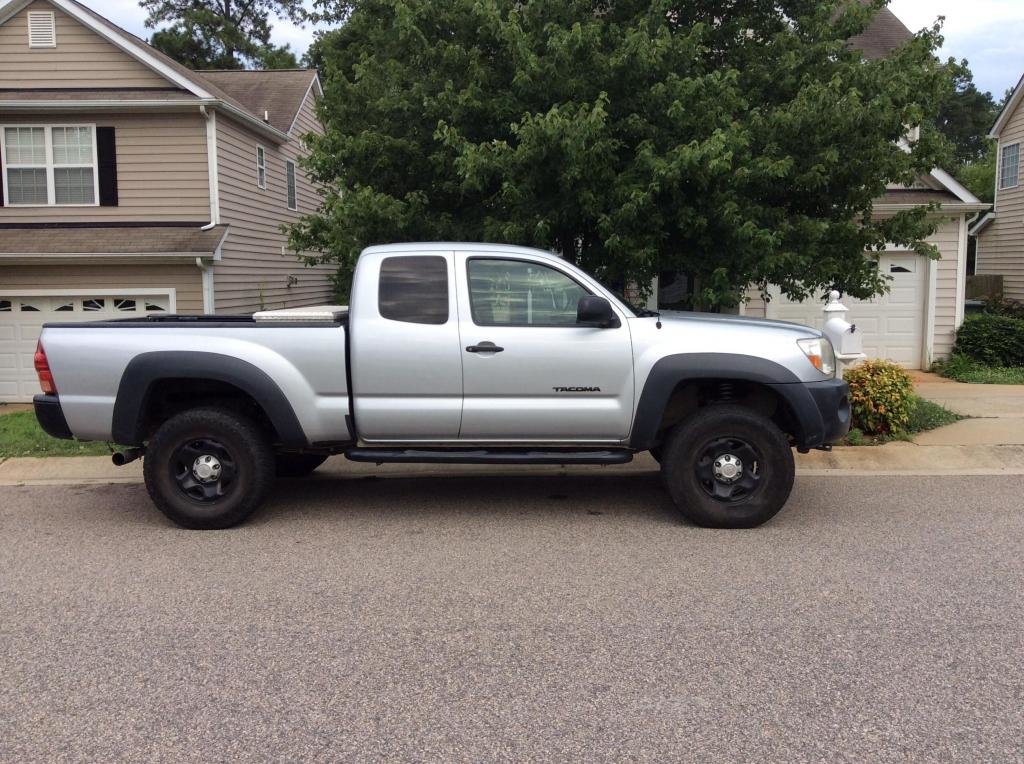

    Well I finished it up today and here is the results! I put the 1.5" AAL in the rear and set the front billies at 2.5" and the front ended up a tad higher than the rear. If hindsight was 20/20 I would have set the billies at the 2.1" setting, the next one down from the 2.5. I really like the way it looks but it is STIFF in the front. Here is a picture afterwards, give me your thoughts.
    Here is a Before/After!!

    what size of tires are you running and i think a 2'' aal would level you rite out but thats my opinion

    The next step down is 1.75", not 2.1".

    I'm running P265/70R17! I think at some point I will lower the front down to 1.75" to make the ride a little less stiff and that should level it out a little more.
