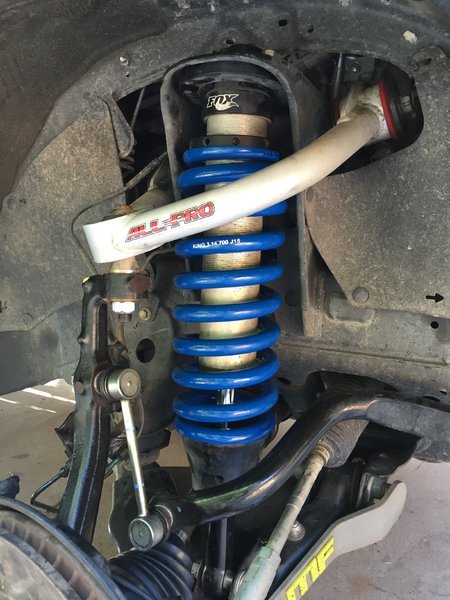

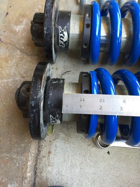

    Update: Got the Fox 2.5 coil overs back from downsouthmotorsports (King 3"x14" / 700#) and the front end rides muuuuuch better. They changed the pre-load which was the biggest help but that was only possible with these heavier springs helping with the front end weight.
    I did get a call back from Jon at All-pro and he was very helpful in answering the questions I had. The guys at DownSouth confirmed too, coils do sometimes rub the shock body and its perfectly normal for a little rubbing.
