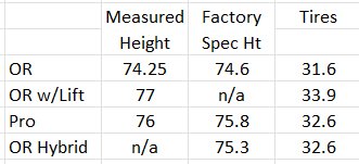

    Video compares a TRD OR, TRD OR with 2.5" lift, and a TRD Pro. The OR with lift also has Toyo OC 285/75/17s.
    Per Toyota, a TRD Pro is only 0.5" higher than a OR Hybrid, therefore the Pro lift only adds 0.5". An OR Hybrid is 0.7" higher than a non-hybrid OR and the tires should have only added 0.5" of height, so hybrids get a 0.2" lift (and a Pro has a 0.7" lift relative to a non-hybrid OR).
    The measured OR was a little shorter than a factory spec OR and when you subtract the height gain from the tires, there is a net 1.6" of lift. If the stock OR was factory spec height, it would have only been 1.25" net lift.
    Compared to the Pro, the lifted OR was 1" taller but 0.7 of that came from the tires. If Pros are 0.7" taller than non-hybrid ORs (tire corrected), then there was only a 1.0" net gain.

    Interesting stats. I wonder why the hybrid OR is lifted .7” over non hybrid OR. Or is it because of the 18” wheels?

    So it seems that the hybrid OR gets slightly stronger coil springs to offset the weight difference (makes sense to me). Presumably, these slightly stronger springs combined with the 32.6" tires on the hybrid OR vs the 31.6" tires on the gas OR are what give the hybrid OR the .7" lift. I suspect the same is likely true with the Sport.
    I wonder if the .2" lift is unintended by Toyota but was nearly to offset the weight difference of the batteries. Or is the miniscule lift intentional to go along with the larger wheel/tire combo?
