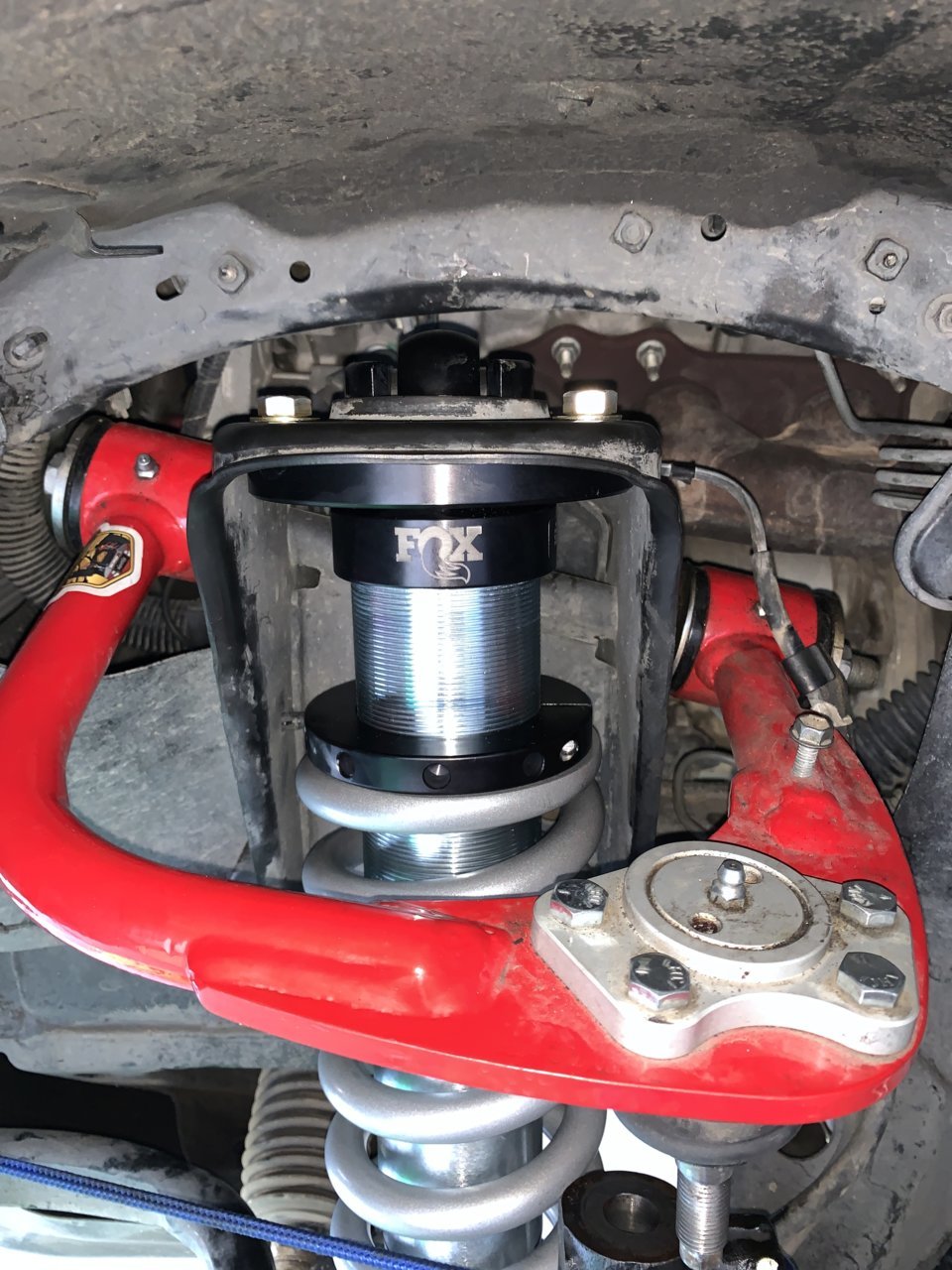

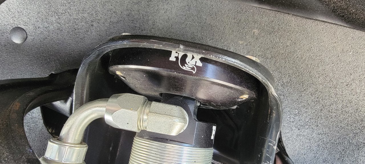

    image.jpg Thank you for all your patience guys. Got the top hats orientated and the spacer on the other side. Looks like it might be difficult to access the preload bolt at this orientation. Didn’t think about that. Will see how she rides first and tackle that as necessary. Threads showing are just shy of 2inches.
