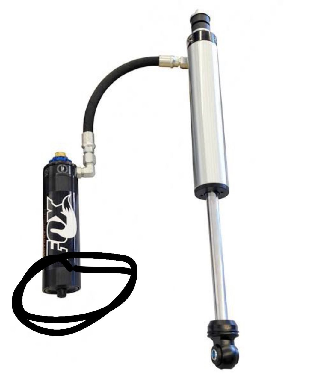

    Hello everyone. I was wondering if you could please help me out with two things. I bought the 2.5 fox rear shocks with reservoir adjuster with 0-1.5 lift for my 2016 tacoma. First I wanted to know how can I control the lift on this shock since I want it to give a 1 inch lift on the back. And second there is a knob at the bottom of the reservoir you can turn around, what is this for? I circled it on my picture. I hope you can help me out please.

    Shocks don't give you lift...the "0-1.5" refers to the height range that the shock length can support, with "0" being stock. If you want lift, you'll need to go with a block (no), AAL, or replacement packs.
    The first knob is the DSC, which controls compression/rebound. The second "knob" isn't a knob at all, it's a cap for the nitrogen
    fill port.
    Hope that helps

    Deaver J66 leaf pack provides 1” lift.
    most AALs that I have seen are 1.5” of lift. Unless I’m missing one out there.
    a 1” block provides 1” of lift but they aren’t great.
