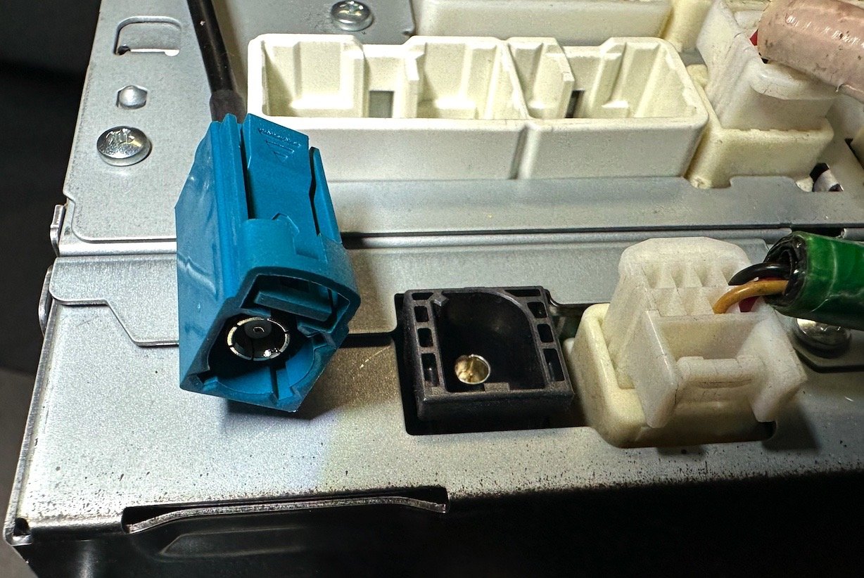

    So I finally got around to pulling the radio and running the new antenna. Unfortunately that adapter won't work.
    I noticed the standard connector will fit in there with a snug friction fit so I will just not use the adapter at all. I'll also put a small glob of silicone sealant as an additional hold.

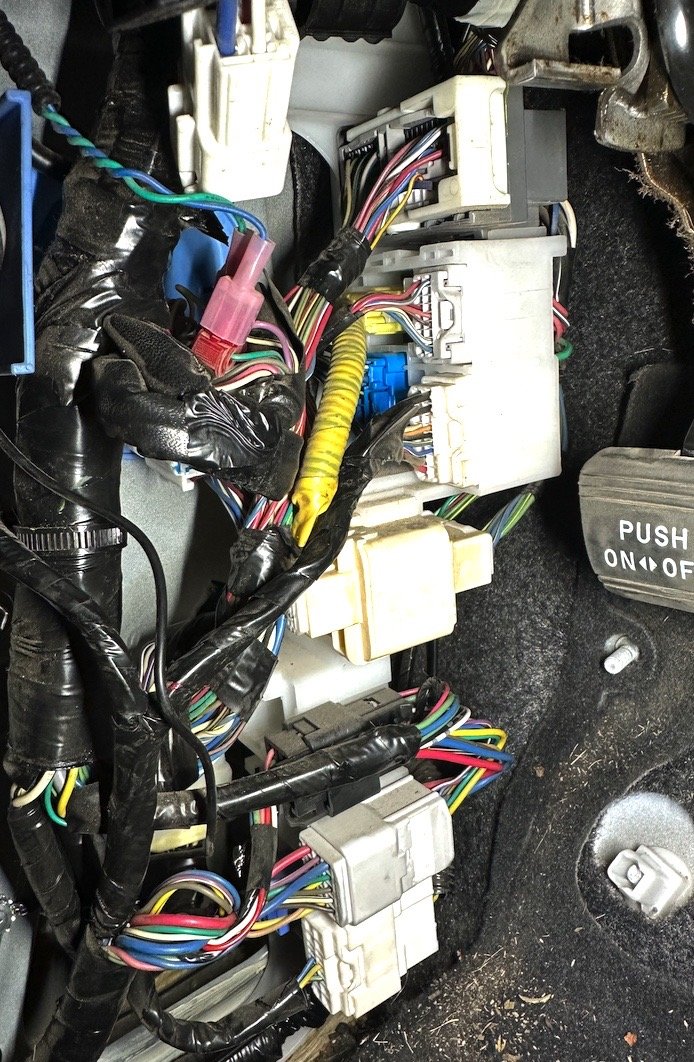

    While running the new cable I took off the kick panel. I couldn't find any connection there either. I guess they moved it or did away with it for the 2.5 Gen.

    Did you look for the connection behind the passenger side kick panel?

    Nope.

    Dash is still apart as I am doing a couple of things while in there. I did plug the radio back in and SiriusXM reception has greatly improved with the new antenna placement.
