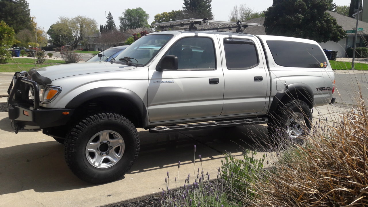

    Oh cool so you are saying that I can just run my stockers with a one inch spacer? That would be perfect!

    I have the same size tire on the same size rim and that's what I had to do. You'll probably have a little more clearance since the tire is an AT. MTs tend to be a little bigger than the size noted on the side wall when they're new.

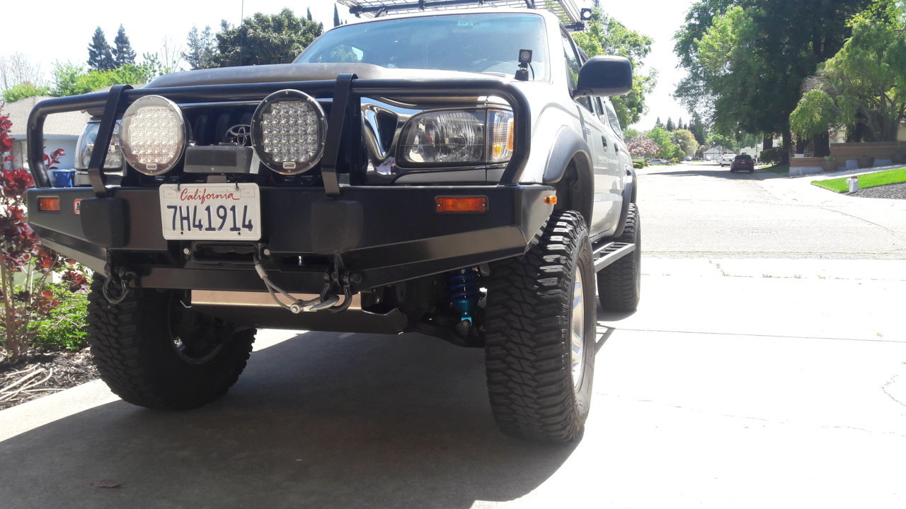

    Hell yea got a pic of yours?

    Will look something like this.
