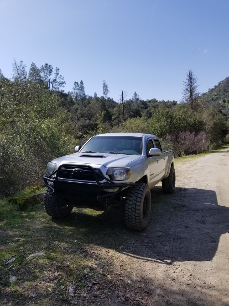

    You don't buy a truck for its fucking fenders!
    2.5" lift w/35's
    315s no rubbing no cutting
    Just a cmc and major fender trimming and pich weld is folded over and before I got the bumper it rubbed like a mf :D
