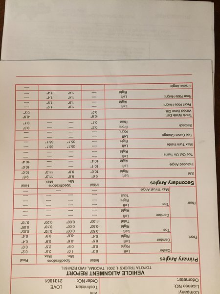

    Post a pic of your alignment numbers.

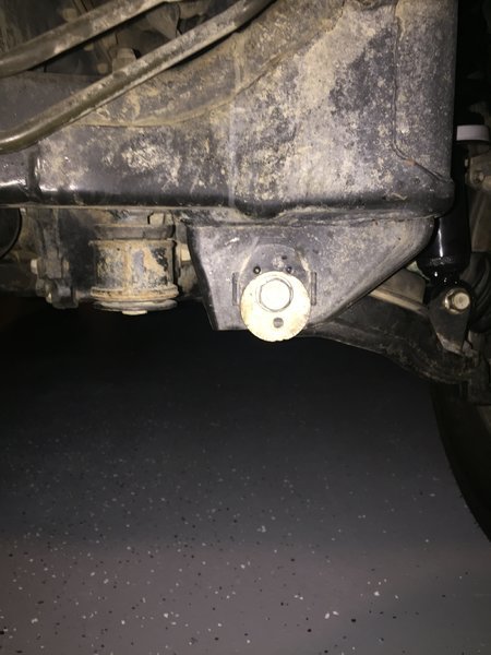

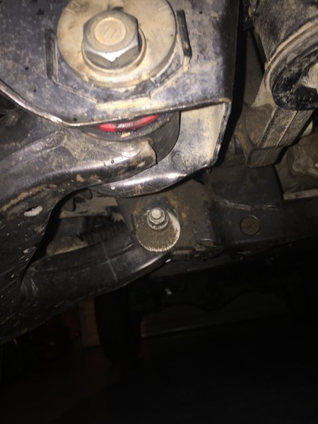

    Check out those washers something wrong?

    Ummm "toe&go"
    You got the toe&go alignment. They didn't even attempt to adjust your caster or camber and judging by the pics, there is still plenty of room to adjust.
    Your alignment is pure shit and you need a COMPETENT tech to take a look.
