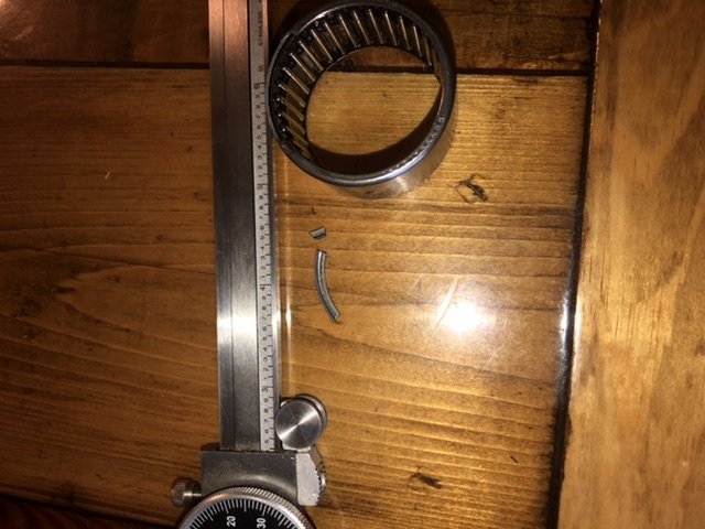

    Oh hey! Yes I did. I went ahead island did the ECGS upgrade. Took care of the vibe. I have the tool and happy to send it to the next taco that needs it. Although, I think it is a tad oversized as it broke a couple little pieces off the needle bearing housing. Got them out with qtips and magnet.

    Caliper for reference

    I lost a needle or two when I got mine out too. Came out on the front end luckily.

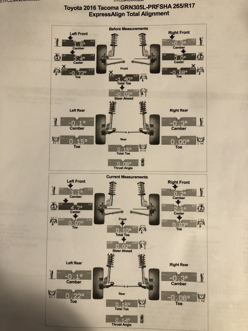

    All specialty shops that have a rack were backed up.
    Had to go to a chain.
    This look right?
    2016 Sport. 2.5”front. 1.5” rear. Freedom UCAs for 2”-4” lift
