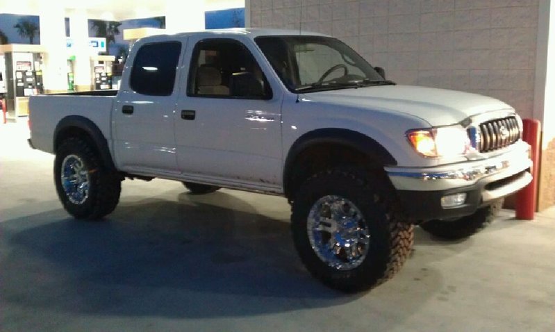

    Here mines on 33 12.50s and 2.5" in the front.

    Looks good man! What backspacing you got on there?

    18x9s with 4.5" of backspacing

    How much trimming did you have to do?

    Beat the pinch weld back and cut the plastic in front of it
