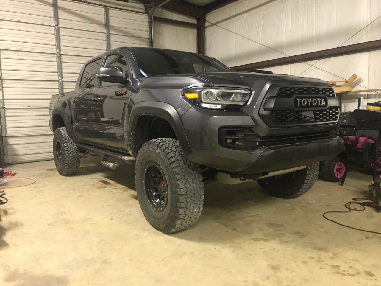

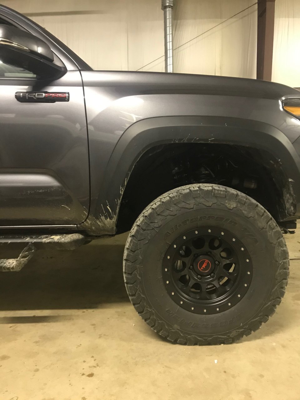

    2020 MGM DCSB
    Kit installed and went with 285/75r16's. They rub when turned and hitting an incline at speed, like a steep driveway or something. Other then that, no issues. I'll be installing a front bumper here soon and I'm going to adjust the caster and move the wheels forward a bit. Currently I'm set at 0 on the control arms which adds +2 to the caster. I have the ability to add more, but am going to do the bumper first and see how much more. If I need to, I can still do the BMC since that's where the tire is making contact.

    Rear is up 3.5"
    Front is up 3" at 15mm preload setting
    This is measured from the hub (so, no tires involved in the measurements). Plus, I guess the Pro is already 1" taller then a standard 4x4 Tacoma. I'll be adding weight to the front as soon as my bumper comes in and winch. And I'll be removing a leaf in the rear spring since I will not be going with a hard topper.
