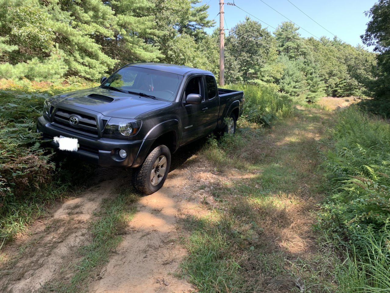

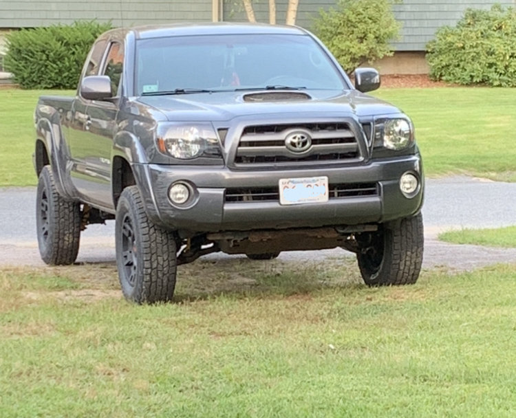

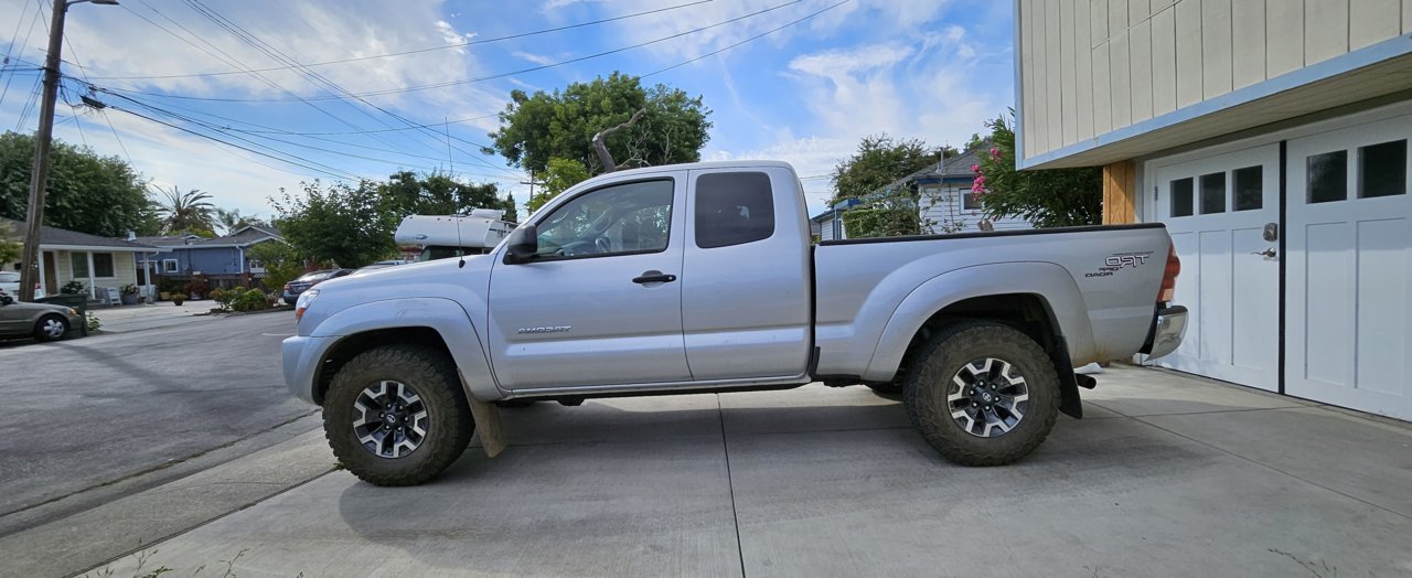

    Spent the weekend lifting the truck. Everything went just fine until I broke a fuel line. Fixed and all good to go.

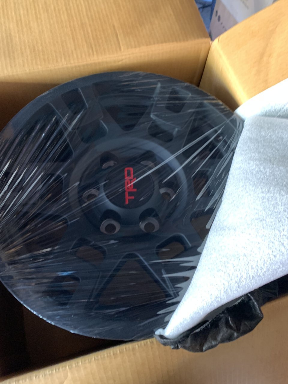

    That looks great, what kinda rims & tire size did you end up getting?

    They are the gen3 trd rims 16" The tire is 265/75/16

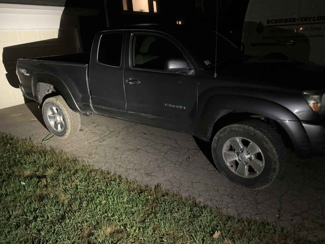

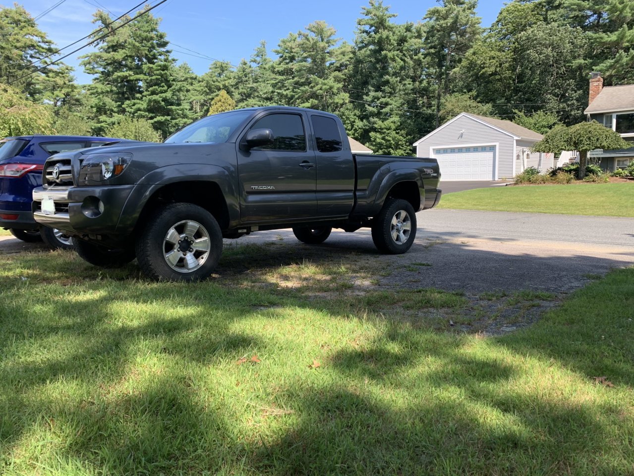

    My ome 2.5 kit w medium leaf came today, only had time to do the rear before dark … check this out it lifted the back 3.5”. Looks kinda silly without the front done —

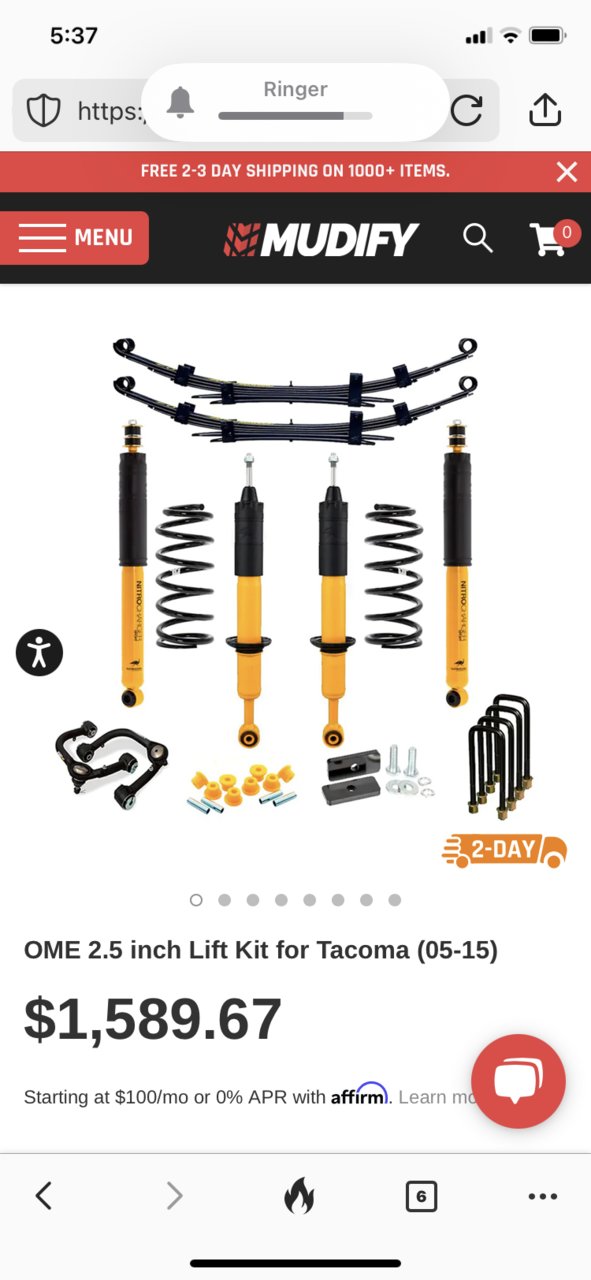

    I gota wait longer, ordered the kit from mudify but the ome upper control arms and wheeler front bump stops from polyformance to save like 65$ w code poly10 10%off . The problem is those don’t come til Monday. Plus Partsgeek never sent the sway bar links like they were supposed to

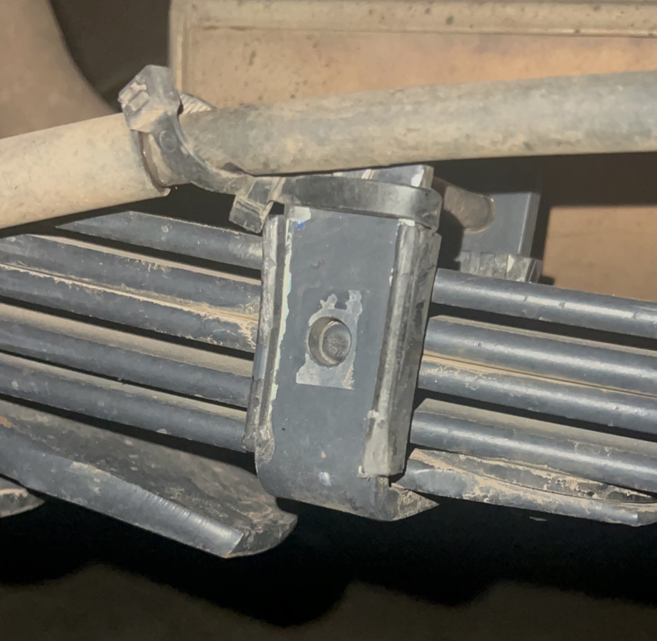

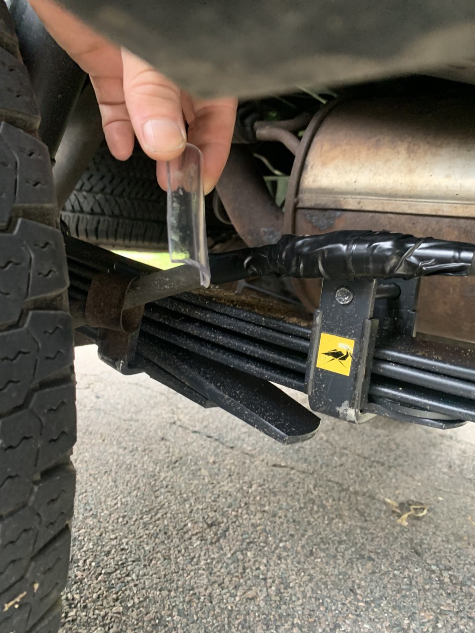

    Does your ebrake line sit right on the sharp corner of the leaf spring bracket now?? I had to cut the lip off the ebrake line bracket with bolt cutters to even screw it to the leaf spring then figured I better use some pvc tape to tape a piece of vinyl tube around the cable where it hits , I guess

    Mine seemed to live right up with the pre made holes. Everything seemed pretty similar to the original

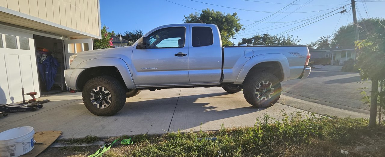

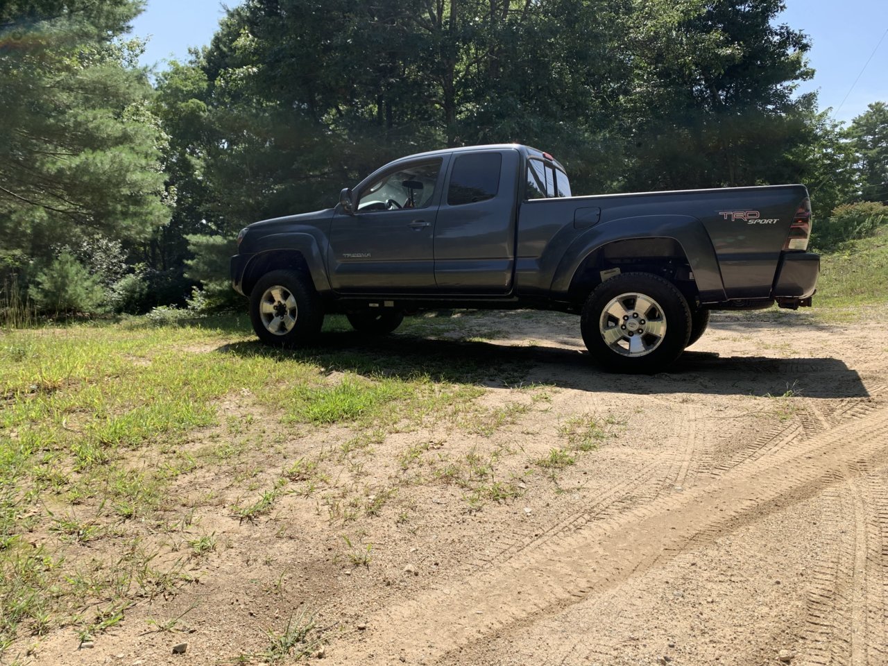

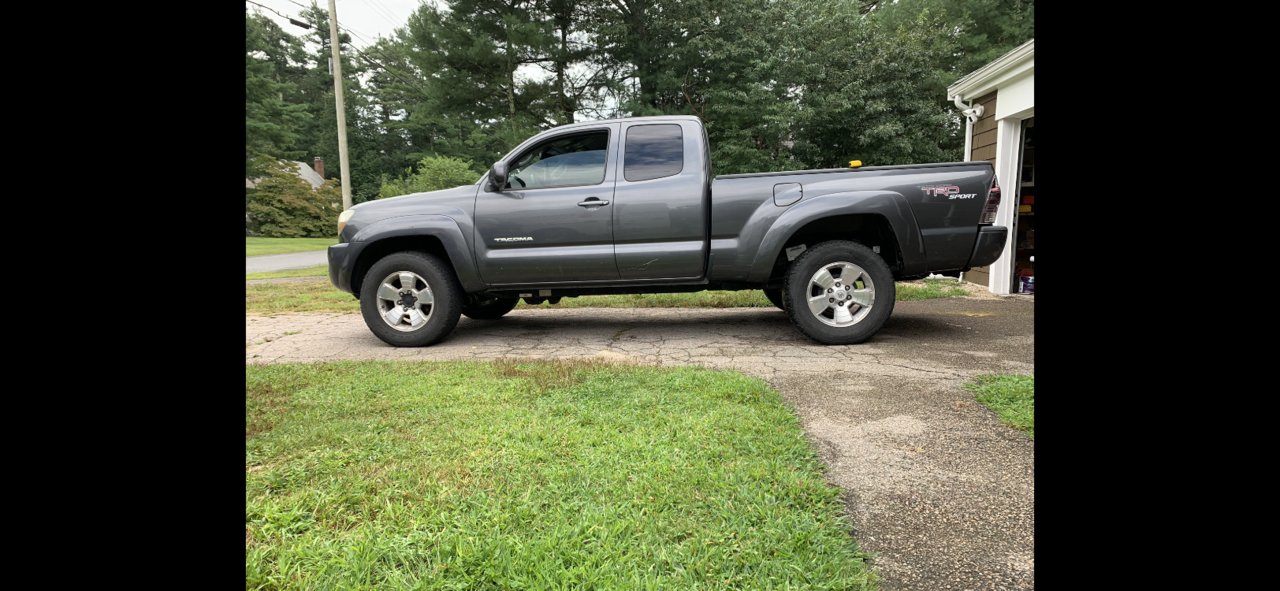

    2.5” ome lift & uca’s b4 and after 2009 sport . Will be .75” higher real soon when the 255/75R17’s come before &after -

    I’m just zip tied at the moment to keep it off the sharp corner. But the bolt head rubs now.. I’ll have to tweak at some point..

    ya mudify was great. fast shipping etc i love my truck now ha but poly performance definitely sold the ome control arms cheaper w code poly10 so i didn't get those with the mudify package
