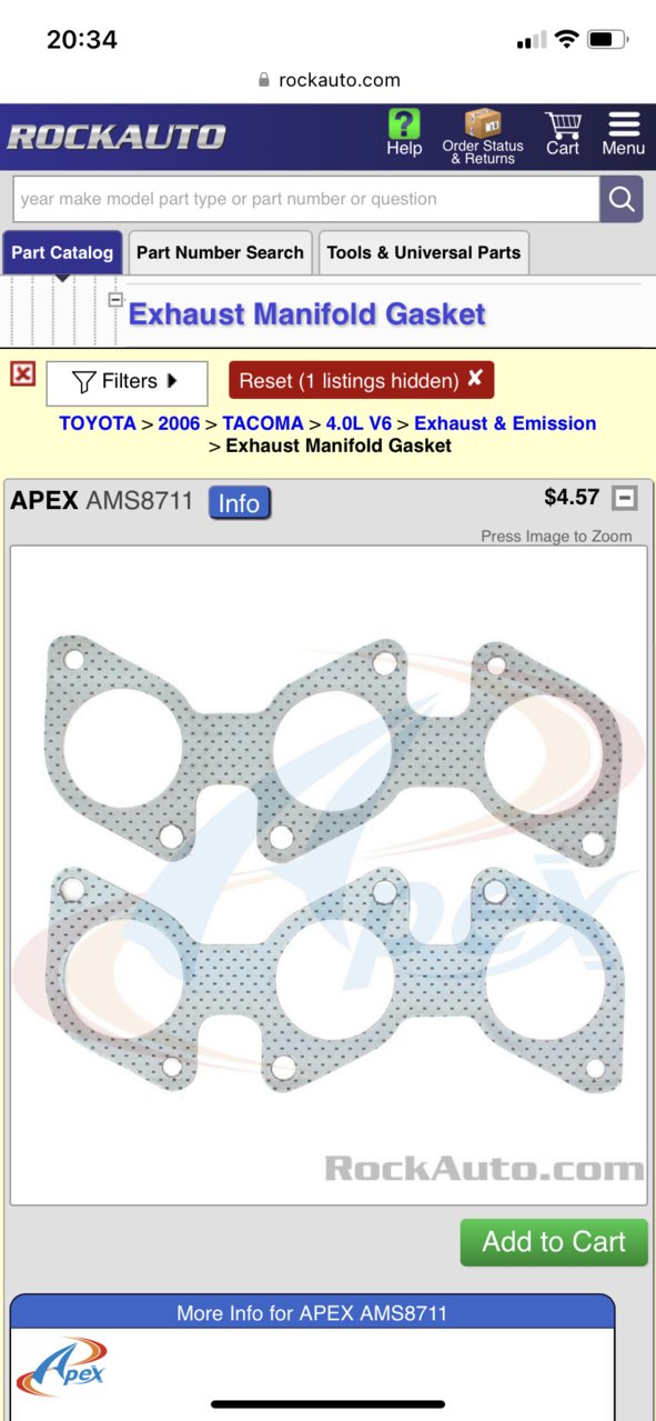

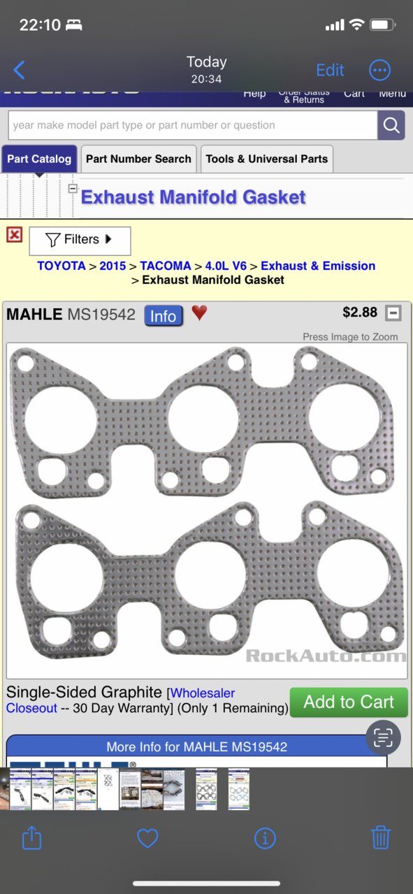

    Looking at the gaskets they look different, anyone actually done this? Which manifold gasket should I use.

    @hx989 you are 100% correct about not needing a block plate. Last time I did exhaust manifolds was on my 2.7L 1997 Tacoma. I think I went through four manifolds before I broke down and got headers .
    Looking at the 2.5 gen vs the 2.0 gen my only thought is making sure that there is a good seat between the manifold flange and the engine. I’m guessing (hoping) the mounting surface on the engine allows for the use of the 2.5 gen gasket as it looks like it will make better contact around the manifold. Just want to make sure I get a good seal. Photos of rock auto gaskets for comparison. IMG_9170.jpgIMG_9169.jpg

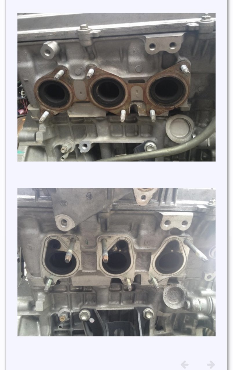

    I only ever start a question thread because I can’t find the answer with the search function.
    What I’m really wondering is if the mating surface between the manifold and gasket and engine will make a good seal. The reason I even have this question is because of what I circled in red in the photos below. It appears there is an indentation on the manifold for the gasket to seat. But is the surface of the engine flat? And will I be able to get a good (perfect) seal by using a 2015 manifold/cat on a 2006? IMG_9171.jpgIMG_9172.jpg
