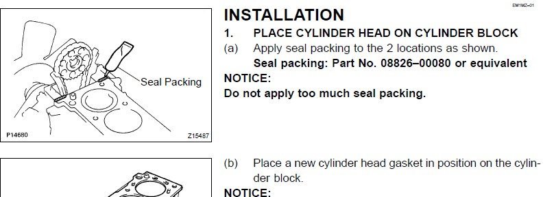

    Hey everyone! I'm doing the head gasket on my '01 tacoma with the 2.7 3rz motor. It made it to 303k! Just got the head surfaced and a valve job done. I'm going to start putting the head on tomorrow. I know some head gaskets require some sort of sealer. Does the 3rz need any? And if so, what kind? Thank you!

    no, but there are two small spots you're suppose to put FIPG prior to placing the head gasket.

    Okay. What is FIPG?

    Form in place gasket, RTV silicone. Use Permatex Black or Grey

    Oh okay. That’s perfect. Thank you for the help!
