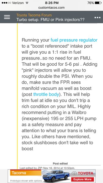

    Can anyone here explain this?

    For each pound of presurre that the turbo creates, it increases the fuel pressure proportionally. Increasing fuel flow.

    Exactly
    In order to get your fpr to read this way for boost you need to connect the vac line that feeds the signal to the fpr to the supercharger so that it reads boost. It's normally connected to your intake box so it only reads vac and no boost since the air has not entered the supercharger at that point

    Find your FPR and the vacuum hose that attaches to your intake. Re-rout it to your manifold, post throttle body. It will cause your fuel pressure regulator to increase fuel pressure as your boost increases but only really helps in open loop. In closed loop, the extra fuel will get trimmed out. For any forced induction, you want a way to tune your ECU for best and safest results.

    Cool, I think I understand. Out ECUs are not tuneable, and they will compensate for certain amounts of boost

    I think the factors varies based on throttle position and RPM but not sure; you'll have to ask around for that answer. If you have OBDII and the appropriate software, you should be able to map where the switch happens.
    A piggy back tuners generally are the cheapest (AEM FIC or MAPECU are the most common). Basically you need something to tune your fuel delivery, be it an extra injector or something that intercepts your ECU signal to the injectors and you need something that intercepts and modifies your O2 sensor reading to the ECU. ECU will never compensate for boost in closed loop and will constantly fight to maintain 14.7 AFR. Even in open loop, AFR's wont fall to far below 14.7 which can be dangerous depending on how much boost you are making.

    I've already researched this. And if you read the beginning of this thread you will see some people here are doing it. From my research, AFRs are in the 11s at WOT upwards of 10psi with no aftermarket fuel management. After 8psi, you do need to upgrade injectors and lift pump.

    But that's in open loop. I'd be worried as a S/C see's boost in closed loop as well :notsure: I'm not saying "DONT DO IT YOU'RE GONNA BLOW YOUR ENGINE!" I'm just saying I'd be concerned.

    ECU will cut fuel using the O2 sensor in closed loop
