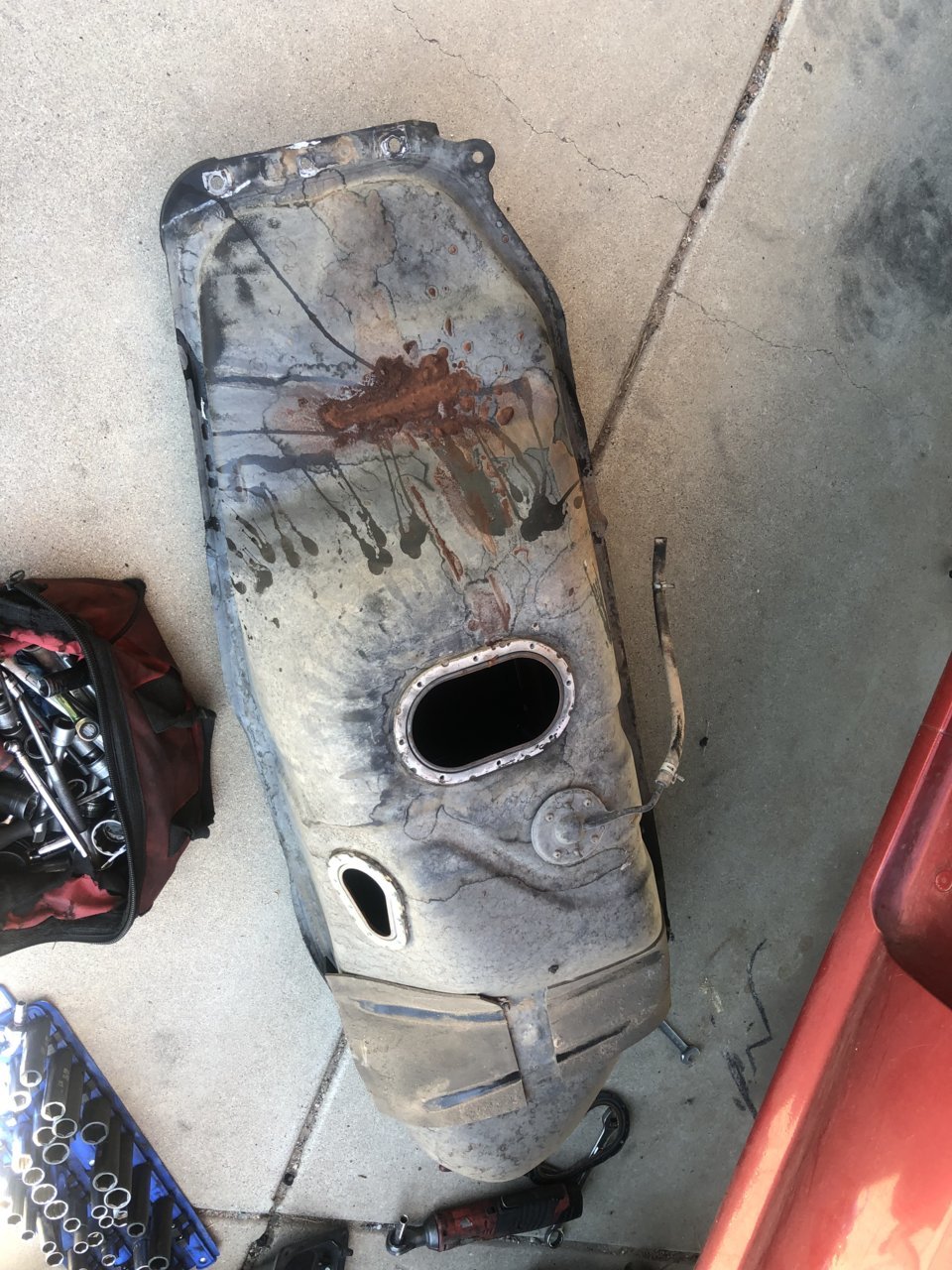

    New fuel pump and new fuel filter going in tomorrow hopefully problem is solved

    Taco is Under the knife now. I will update when Done.

    Clean out that tank Kaka

    New Pump and Filter Done. Cleaned a Bunch of Crud out of Tank. Runs Smooth and No Hesitation while Driving it the Little bit that I Did. I will know for sure tomorrow when I'm in traffic. If I got it to a 1/4 tank it would Hesitate like Crazy. I was shutting it down at every stoplight. No fun when it's 110 outside. I hope I can close this bullshit chapter once and for all.

    Congrats on fixing the problem. How did you clean out the tank?

    Rinsed it out and put some Rust Dissolver in at Full Strength for about a Half hour or so. Sloshed it all around. Then filled it up with water for another half hour or so to sit with dissolver diluted. Drained then rinsed out again really good. Sat and let dry out. A lot of Shit came out for Sure. Runs like it did when I got it. Stoked its Fixed.

    So you had replaced the fuel pump once before right? So I guess the issue was crud in the tank then?

    Correct. When I replaced the fuel pump the first time I did not drop the tank and clean it out. I picked up the bed moved it back and changed the pump that way. In the matter of about four months the hesitation started.
