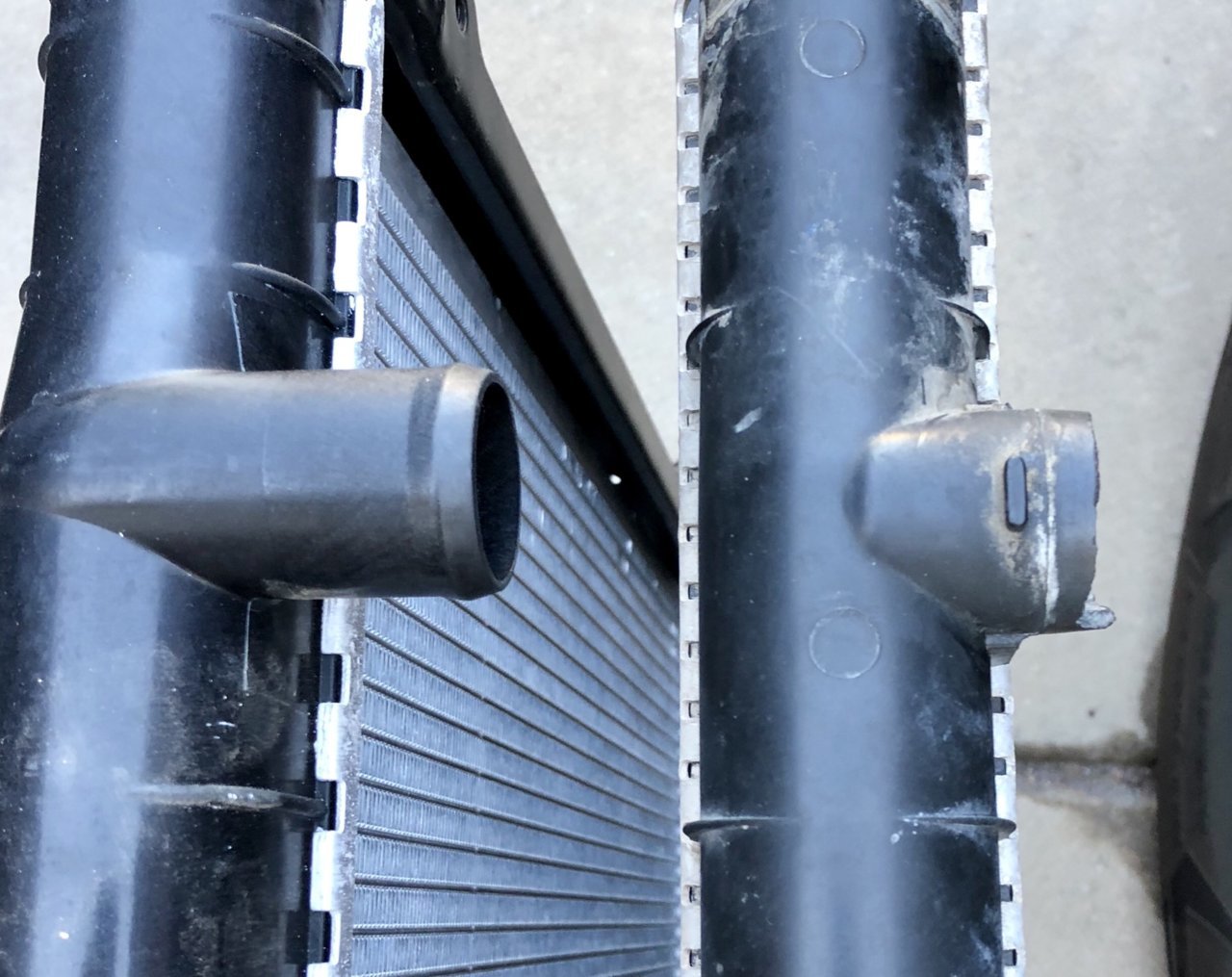

    I have had 0 time to deal with this. I was Burned pretty Good when my UPPER Radiator Hose decided to come off and Blast me Good. Hopefully be healed up soon. Replaced Radiator myself today so at least that part is fixed.

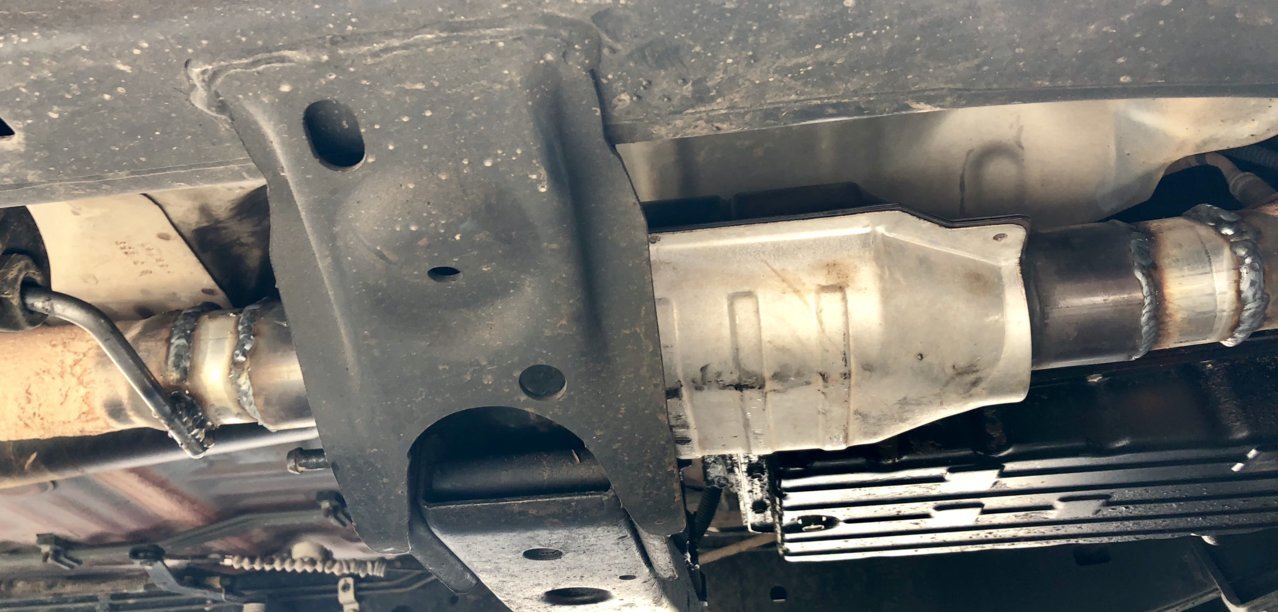

    I Believe I Have a Exhaust leak after I Had to replace my Cat after it got Stolen. May be a part of it.

    Found out a Flange on my exhaust was bent when my Cat Was Stolen. Has to be cut off and a new one welded on. Exhaust leak will be fixed today. Does is have any bearing on the hesitation issue. We will find out today.

    No More Leaky Leaky

    Problem Not solved but Not as Bad. Son is driving it and updating me. He said its more managable. So something is still lurking. Also found out today that before it would die the CEL would come on and go off after it was started again.
