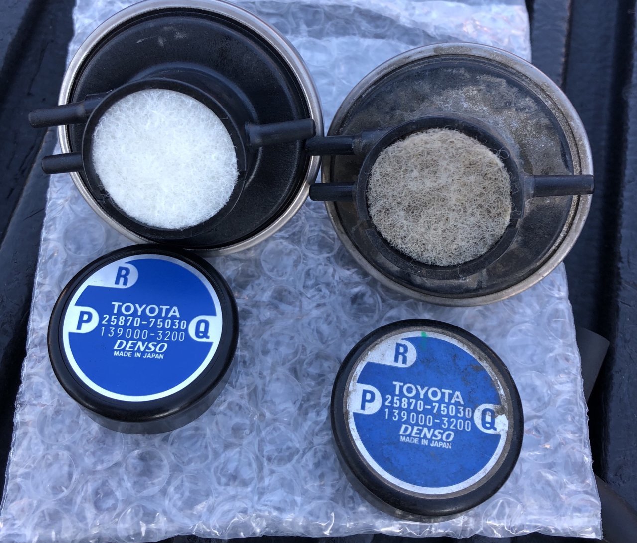

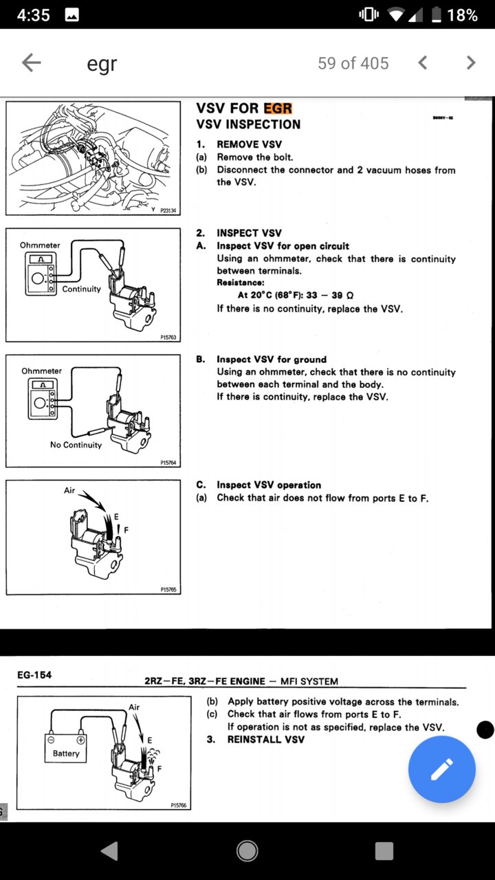

    It's good you are fixing this issue. To me it would make more sense if it was excessive flow P0402. That would make sense as far as the hesitation issue goes because you could have been possibly flooding your intake with exhaust gas causing it to stumble.
    But for insufficient flow, hmmm....So maybe you have a cracked hose, or another component in the EGR system that exposes a vacuum leak when the computer calls for the EGR to open the VSV. Another potential issue is the EGR temperature sensor. This sensor could be sending a false reading to the ECM causing all kinda of things to happen. There is a drawing from the FSM you should look at to better understand the issue, I'll try to get it for you.

    Here is some information from the FSM. Hope it helps.

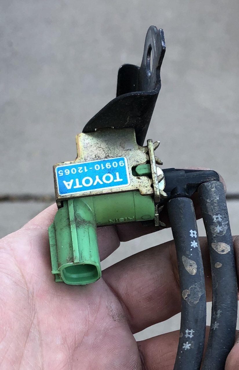

    7A5D59EF-80AD-4D26-98FB-2B4D7A3968C2.jpg Lil Bastard is Out

    Nice. Does the Valve hold seal? Is it clicking and changing states when you put 12 volts to it?
