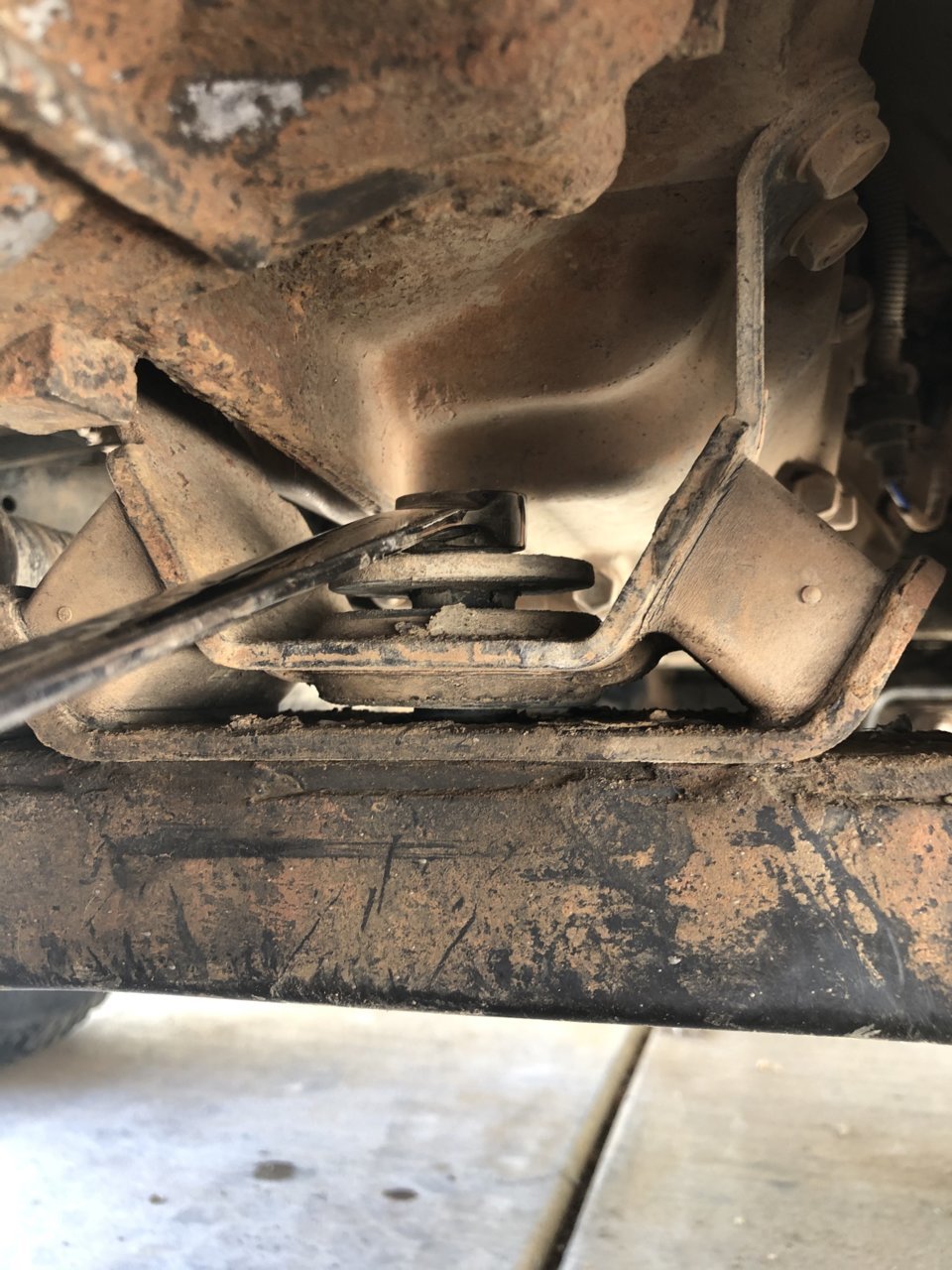

    No leak at all from bell housing, and all the mounts are old and brittle but still in-tact. But not sure if the transmission mount is ok or not, I will attach a picture. Is there supposed to be that gap between the bottom of the "washer" and the top of the rubber mount? I tried to tighten it up, but the threads would just spin in the crossmember. Let me know if this is a problem, or not!! Also, my carrier bearing has about a half inch of play.... that seems like a bit too much haha.
  12. Apr 21, 2021 at 5:32 PM
    SLAPS 65
    SLAPS 65 Dirty deeds, done dirt cheap..
    Jun 11, 2018
    #256167
    518
    Leif
    Nor Cal east Bay Area Ca.
    2000 Tacoma 4wd ex cab 3.4 auto.. manual hub, J shift
    How smoothly did the engine mate up to the trans when you installed it?
    The engine and trans should mate up easily and smoothly all the way home, bell housing to block. No pulling it together with bolts or pushing it together with pry bars. You have symptoms of a bent clutch disc hub which can happen if the engine or trans goes too far out of square as they are assembled , the input shaft of the trans bends the disc before it gets into the pilot bearing. Check out all other suggestions out of course but it sounds like a bent disc. If it is and you go back in to change it, replace the whole clutch and surface the flywheel again. If you’ve been driving it like this chances are the pressure plate is heat spotted as well as the flywheel. I did this once to my own truck as a teenager trying to bench press the trans in by myself, 40 years ago and I’m smarter now. and have changed out a couple of new clutches at work over the years due to this.
