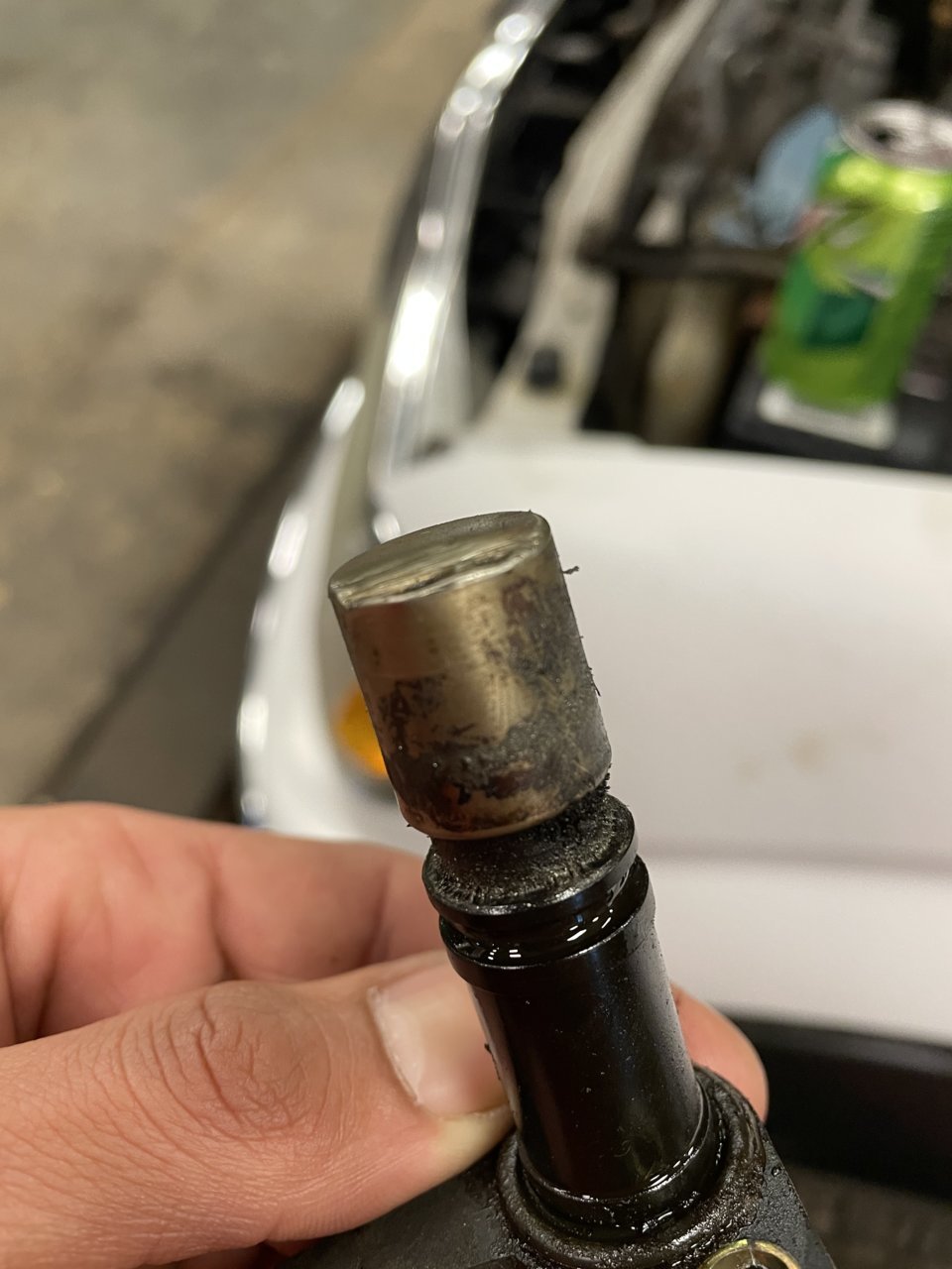

    Here’s a pic of the sensor, after looking down through the timing chain area it appears the tone ring is sitting cockeyed. I couldn’t get a good pic of it but it’s clearly not even like the lower timing gear. I’ve looked but not finding a tone ring kit does anyone know if it’s available BE653E49-1389-40C0-A3ED-CE77CD5F5F4A.jpg

    Judging by that damage I’d say at least pulling the timing cover is in order... try pulling on the crankshaft and see if it moves back and forth. Maybe the thrust bearings are shot? Only time I’ve ever seen something grind a crank sensor like that

    I should have cover off tomorrow it was time to shut down for today and watch some football. Could the timing chain having a issue cause this also? Do you happen to know if replacing the ring is an option?

    Well I was finally able to get back up to the shop. Timing chain gave and destroyed the tone ring.
