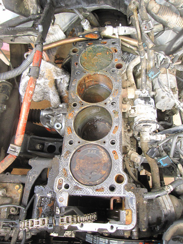

    I just took my head off from my 99 2.4 because of bad head gasket, the work isn't too bad. Now I am taking all the valves off and clean/lap. PM me and I can send you few pages factory service manual to show how to do the work. I would recommend you take the head off yourself and send it to a shop to clean and replace the valve and check for crack, OR just buy a complete rebuild head with cam on ebay for about $600.
    Too bad you are not local, otherwise you are welcome to come check out my work. Best luck!

    Youre using tap water, arent you?
    Drewwnc likes this.
  10. Oct 23, 2015 at 12:49 PM
    parahelium
    parahelium New Member
    May 18, 2014
    #130116
    4
    Long story short, the truck has 340K original miles and my father drove it probably 100K miles with a bad head gasket. When I service the truck, I always use distilled water only 50/50 mix, but I know my father been adding water and probably tap water.
