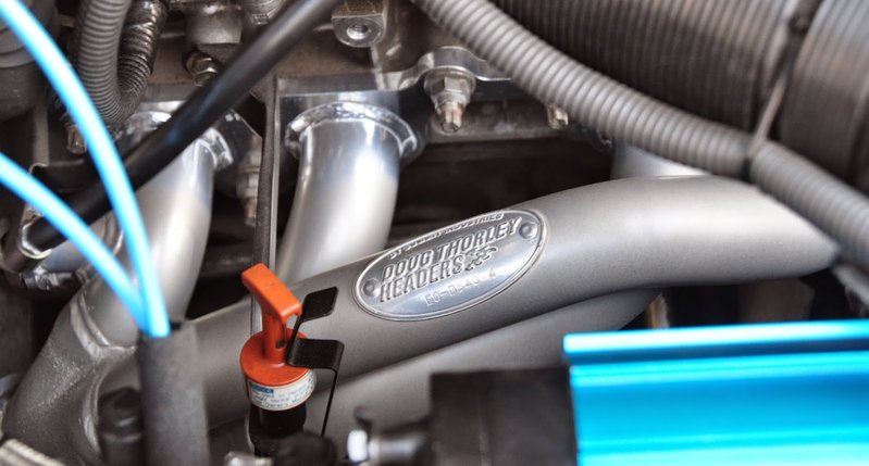

    Ritchie
    Ritchie Well-Known Member
    Dec 24, 2012
    #93649
    1,931
    San Diego (North County)
    RC Step side Pre-runner
    2.7 w/auto, 4WU 3 link, F & R Diamonds, ARB's F/R w/ Yukon 5.29's, Inchworm 4.7 Lefty, Deavers, ARB OBA, Schrockworks up front.
    ... what Speedy said.
    I had the OEM mini-header which was stainless. It was really ugly + the 'under the hood' heat was too much for some added wiring I had done.
    Went with the Doug Thorley from LCE. It is CARB legal in CA. The aluma-coat also dropped the temps under the hood too.
    Here it is:
    mohavestubbs and SilverGhost like this.

    That not the header we are talking about. We are talking about the actual header lce makes

    I understand that. This another option for the OP that LCE offers.
    The LC header, long tube or mini, is not CARB legal for CA which is a bummer.
