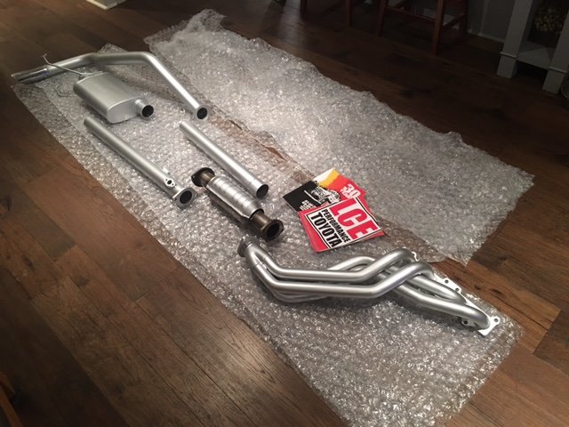

    Well convinced I am. Here it is. We shall see the improvement. Unfortunately I don't have access to a dyno to "prove" the gains I may experience. I am sure it will be much better because I have certainly felt a loss in power over the last couple years and the only noticeable issue is a cracked manifold. Sounds and details of experience to come. If you have any installation tips, let me know.

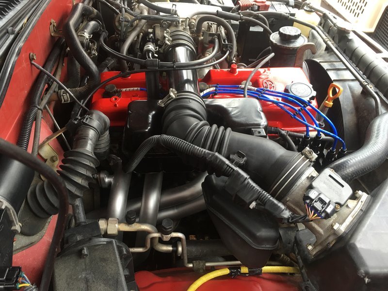

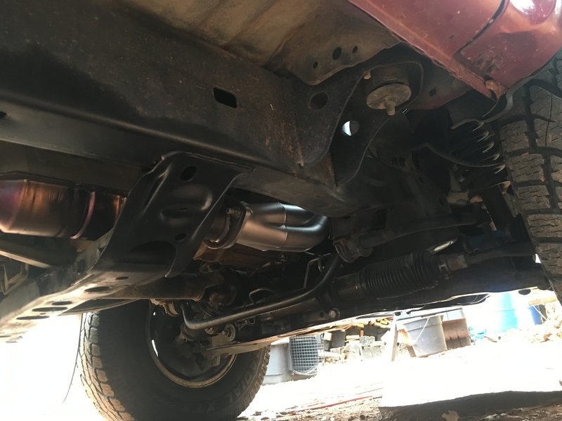

    LCE Header is in.

    Still happy with the purchase. Overall things seem to be running much smoother. Regaining gas mileage has been a nice add. It's still nice to here the crank up and slight purr. I've gotten a couple compliments and funny enough had some people ask if it was a 6 cylinder (because of the full exhaust system).
    Took it for a long ride up in the mountains this past weekend. Ran some seafoam and non-ethanol 93 octane through it to clean out and shake off some dust since its been a secondary vehicle for the last year or so. Idles great and pulled up the long grades better than it ever has.
    I do have to make adjustments to get the heat shield around the catalytic converter out of the way. Certain low rpms cause the exhaust pipe to ting on the heat shield a little but it will be easy to fix. It hasn't bothered me enough to do it yet but I'll probably knock it out this weekend.
    Overall, I would do it it again for sure. Since I installed it myself, it was totally worth it because the cost wasn't much different from going with an OEM mini header and LCE sent every part and piece I needed to install it.
