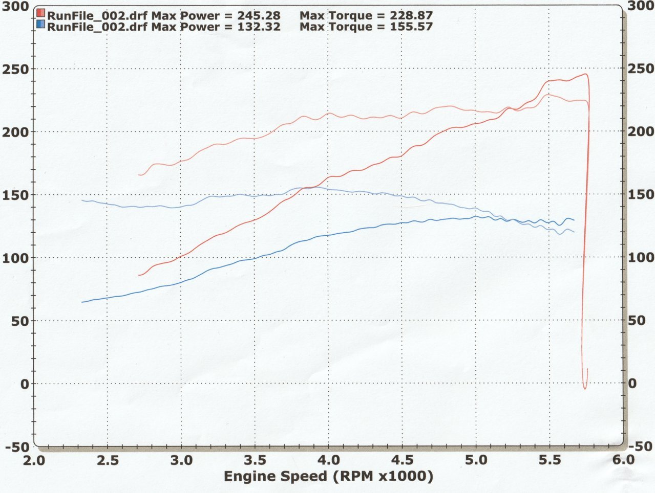

    Wrong. This adds more power at every RPM
    Can you show me a Dyno sheet from a turbo 2.7 Taco with more than 245HP?

    Ugh! Where did I say your little belt turbo doesn't increase power down low?? By the way your dyno chart starts at 2,000 rpm and everybody who's driven the little 2.7L knows that it struggles the most before 2,000 rpm.
    Enjoy your truck man. Glad you're happy with your investment. Don't need to be defense and spread misleading "info"
    For $5G plus tax and install labor (for those incapable of installing) there are other options than the URD kit.

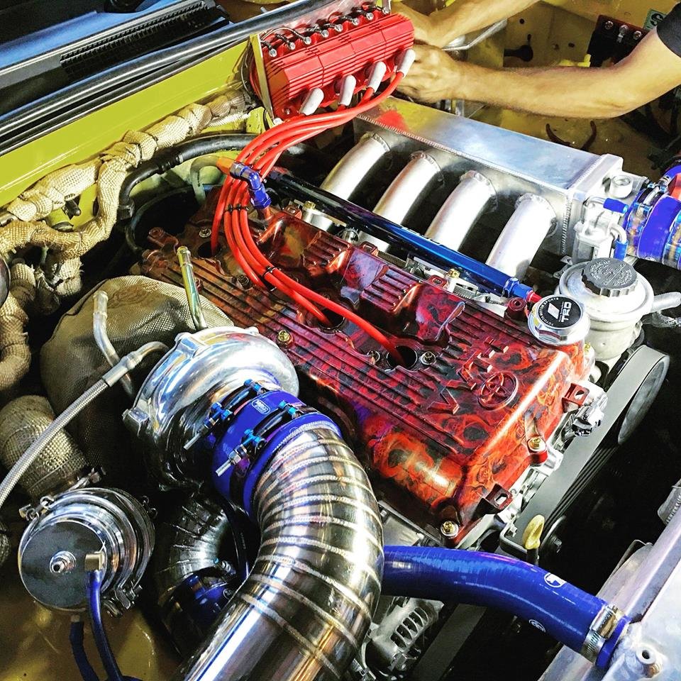

    A whipple or roots would make power everywhere. Your curve will unfortunately mirror a turbo style curve. It's more controlled of course, which is attractive, but IMO it takes the fun factor out of it

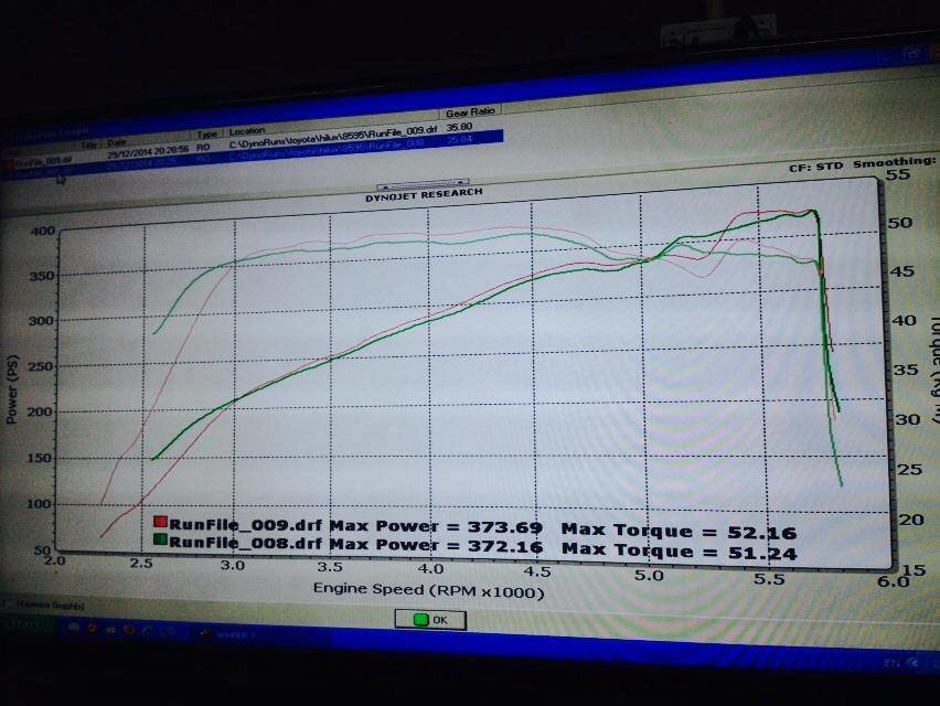

    In the 1st one your torque is 52?
    If this is real well f'n done?

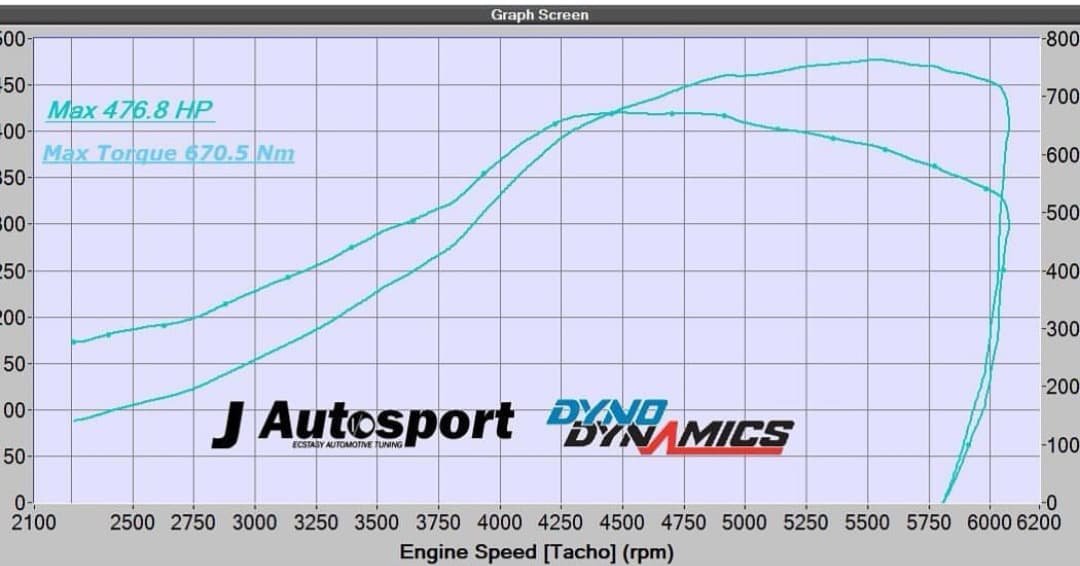

    Not mine, but a good friends
    The RPM trigger wasn't hooked up, which messes with the torque readings.
    And the second graph is the same motor, just more stuffs done to it
    Pretty cool setup. Can't wait for mine to be done. It will surpass his in performance, but might not look as good as his engine!
