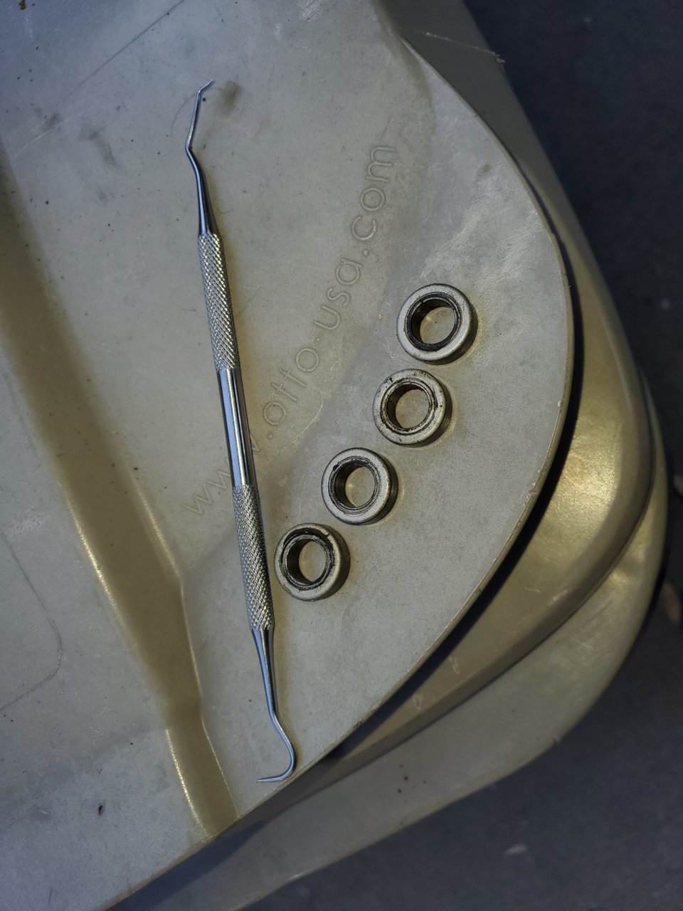

    figured I'd post this question to this thread, since it's the one that comes up on a google search.

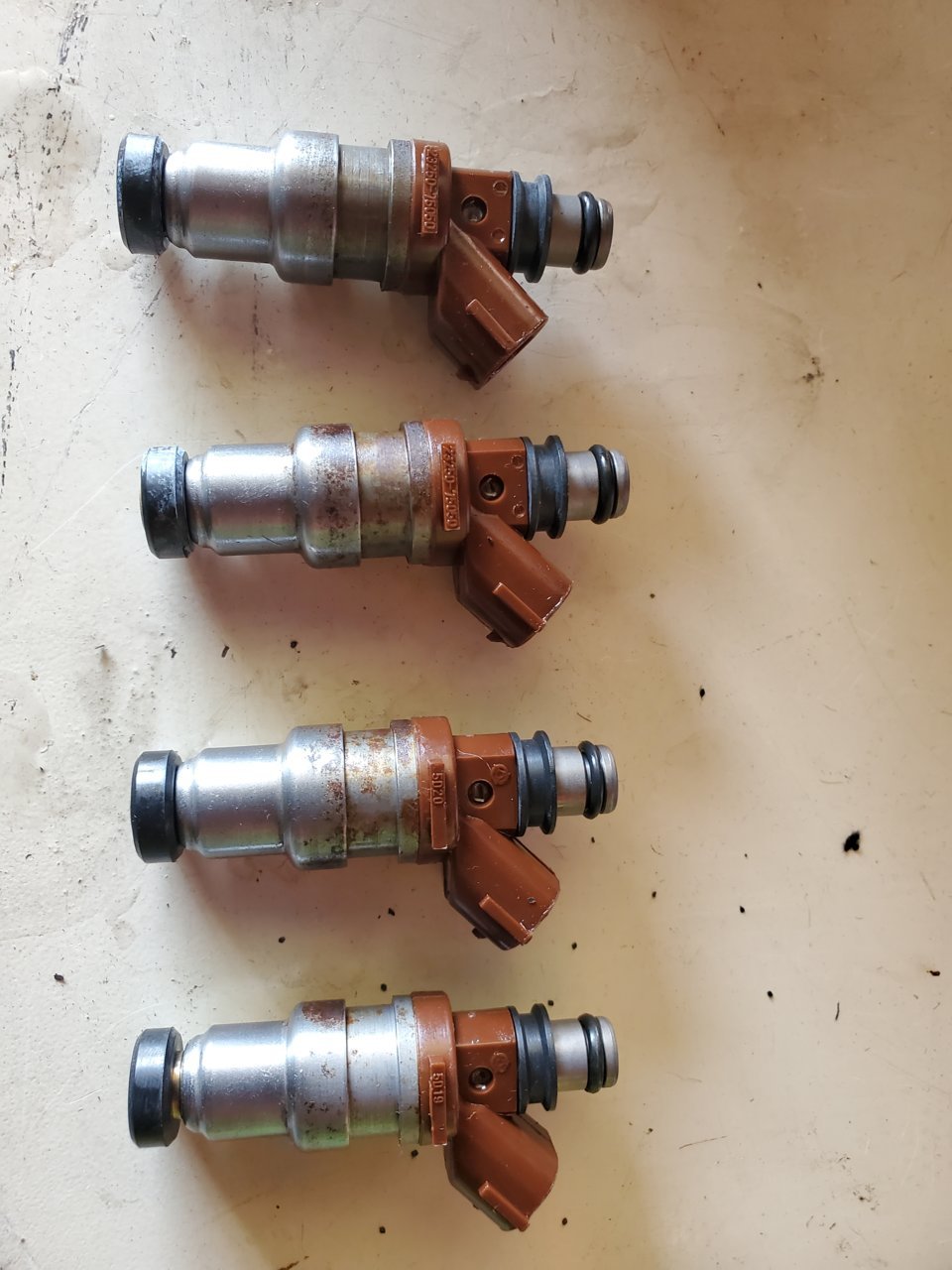

    I've pulled my injectors for cleaning. The cleaning is done, but I'm not sure how to proceed at the moment.
    Here are my cleaned injectors with new seals.
    Here is my cleaned #1 injector cup (or spacer as per @DrZ pic).
    The insulator (as per @DrZ pic) inside the spacer honestly looks and feels like it has a metal bushing inside it.
    When the injectors came out, they were coated in RTV.
    I assume the last time the injectors were out, the insulators weren't replaced (why else would you seal the injectors with RTV?), so maybe the insulators just look and feel like metal because they're that old??
    Like I said, I don't know how to proceed. I've picked at the insulators a bit with a dental pick, and, like I said, they feel like metal bushings. I'm a little worried about going after them because of the risk of breaking the spacers, but maybe I'm overthinking this.
    Sorry, I get like that when the thought of having to pull the head comes to mind.

    Well, I plucked up some courage and got them out today with the dental pick.
    Seems they'd been painted, which was adding to my concerns.
    Everything is back together, just waiting for the paint I sprayed under the battery tray to dry before I make a test run.
    I will add that the new insulators are VERY easy to lose (ask me how I know), so do whatever you can to prevent that. I wasn't having much luck putting grease on them to keep them stuck to the injectors during install, so I just installed them in the head and snuck the injectors into them there. Not sure that's the best way, but it seems to have worked.
