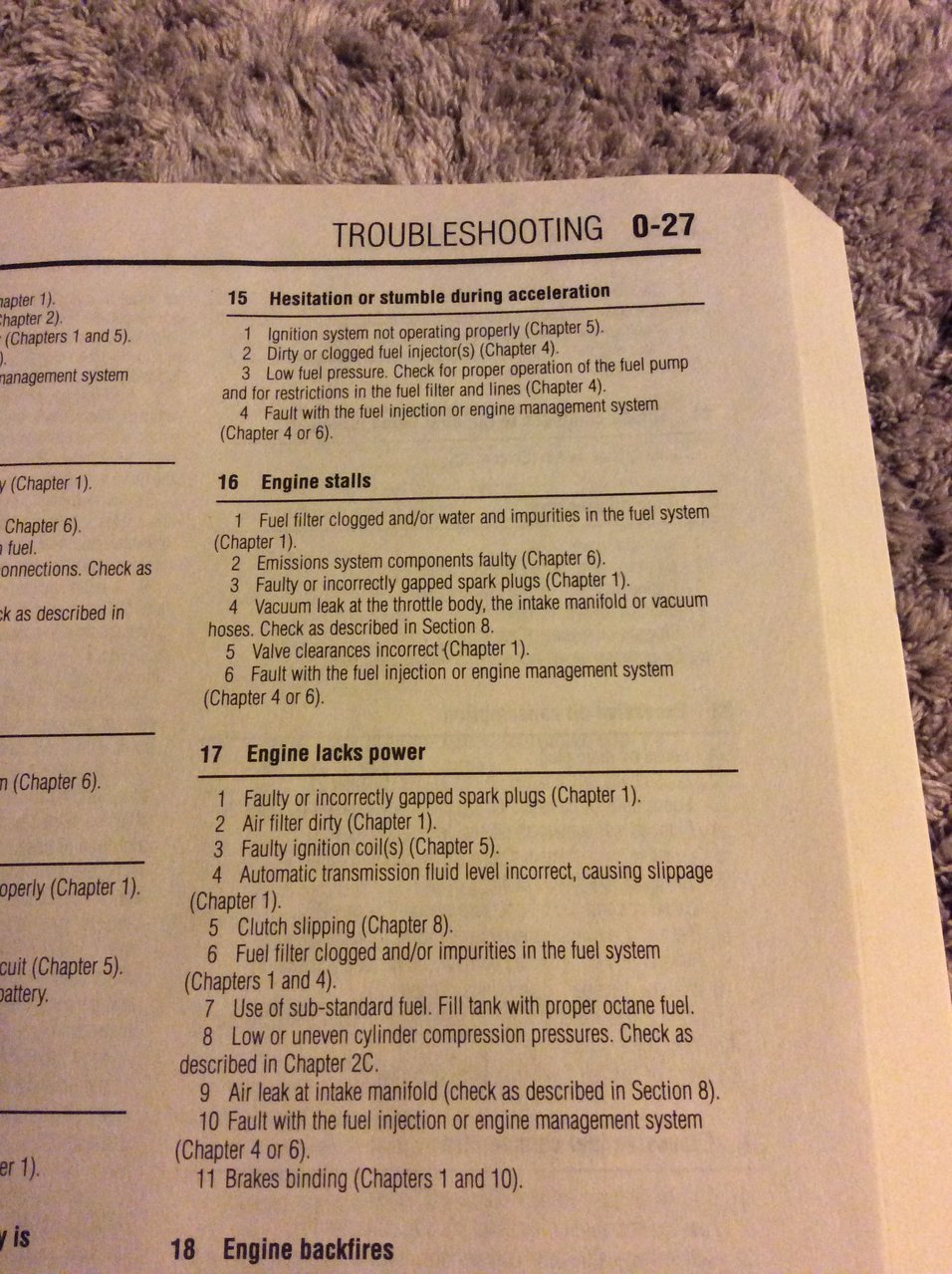

    If you’re looking in the Chilton manual, I believe they have a few avenues to look into.
  6. Feb 7, 2018 at 2:44 AM
    tacoscull
    tacoscull [OP] Gold Member
    Aug 25, 2017
    #227971
    8
    Boise, ID
    2000 SR5
    Headlights, taillights, interior led lighting, inst. cluster leds, custom intake, DNA headers, flowmaster cat back
    Ya I got a Haynes. Pump's resistance is in spec. Same with injectors, coils, wires, and the ecm. Picking up a new pressure regulator today since I read a thread that mentioned its a common culprit.
