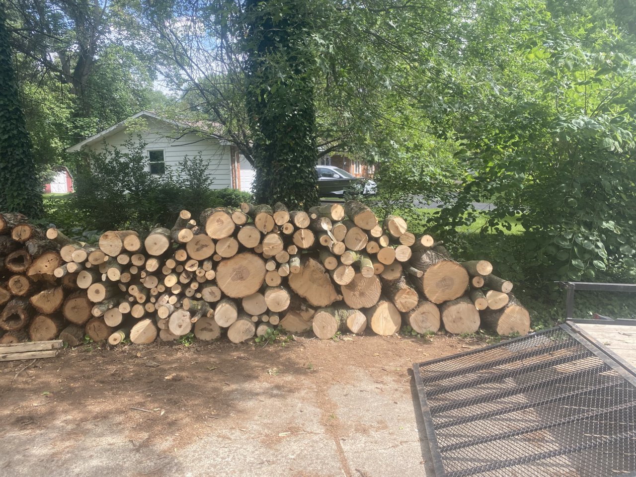

    What’s the biggest thing you’ve hauled with your 4 banger or any of you guys use it for fire wood hauling? In the pic is a 6x12 trailer full of maple a little over a cord give or take. Estimating a weight of a round 4000-5000lbs and am starting to worry if I’ll break something do any of you haul anything that heavy with yours? upload_2022-6-5_20-34-43.jpg

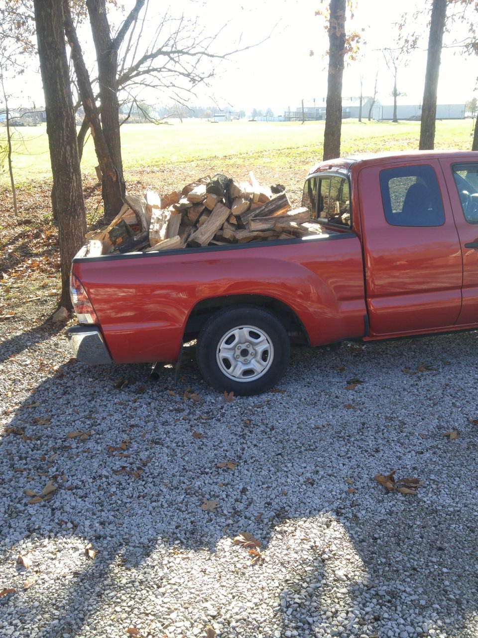

    two trips...

    There is a lot to towing capacity, people often think of power, cooling, strength of frame, etc.
    What is most often overlooked is the mechanical advantage of the trailer against the truck - leverage.
    A pallet jack makes a good example if you are familiar with one. A 200 pound man can tow a 2000 pound pallet easily on a smooth concrete floor even though the pallet is 10X heavier than the man.
    Now try to stop or turn the same pallet suddenly -- it doesn't matter how "strong" the man is, the weight of the pallet now easily overpowers him. Try the same pallet on a slight incline either up or down, the weight wins every time.
    Substitute trailer for pallet and truck for man -- this is always the light truck towing capacity problem.
    If you truly have a 4-5k load on the trailer you have:
    1) exceeded the 3500 pound towing capacity of your truck
    2) passed by the general requirement for electric brakes
    3) the trailer is probably rated for 2290 pounds GVW so you would be over that as well -- could be setting yourself up for a ticket or a lawsuit depending on the situation
    Will you break anything??
    Maybe or maybe not, how much luck do you generally like to count on and how much disposable income do you have for repairs?
    Keep your loads lighter, you will be safer and everything will last longer.

    Longer trailers are night and day easier than shorter trailers. Truck didn’t do too bad I went slow there’s one hill I struggled with cuz I couldn’t gain speed turned and the hill was right there. Other than that breaking was my main concern and of course hoping something doesn’t break lol

    I’m not sure if I had that much on that trailer or not I’m just going by what the internet says that much wood could possibly weigh

    So your concern was braking and breaking! I also have an Access Cab so with your photo now I have an idea how much I can fit in the bed. If you only had trouble with one hill that's not bad considering the huge load you had.

    More than likely I’ll be taking smaller loads in the future didn’t realize how much weight was actually back there. But yes it is good know it could do it lol
